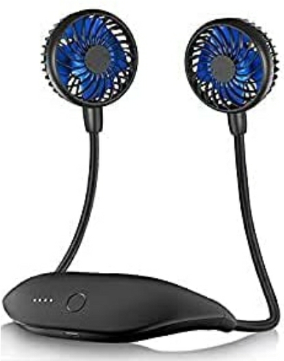

The only issue I see is how would I use my neck pillow or neck fan?
They should seriously combine the Dual Sense feedback and fan. It might seriously compliment the PSVR2. ! Imagine playing Iron Man VR in that.
Or getting your neck snapped in VR.
Lol I just realized there’s a surprising amount of neck accessories. :rofl::rofl:
