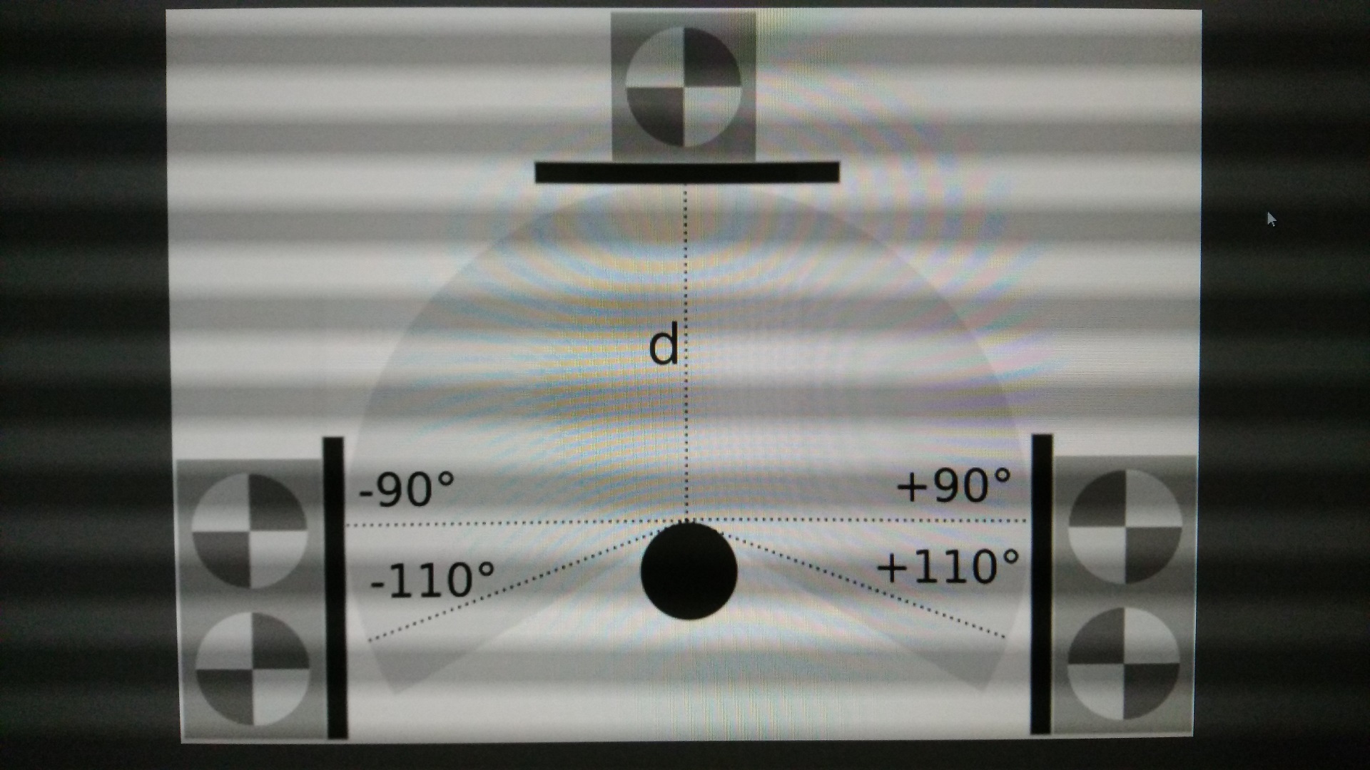

DOWN TO EARTH TEST:
These picture frames were taken using a Sony CCD, said to be one of the best in its class (23 MP), capable of Full-HD at 100Hz.
Since the shutter speed is ofter higher than the subject refresh rates, bands and black screen insertions can appear in the resulting image, otherwise no bands and/or flicker would be visible.
                             LG IPS 29' Ultrawide monitor @60Hz (Default).
                          LG IPS 29' Ultrawide monitor - Overdrived @75Hz.
Thinner and less evident banding observed, due to the higher 75Hz (closer to the CCD shutter speed).
 LG curved OLED Tv 55' at 4K , auto refresh rate (Game mode - highest possible setting).
No bands visible and no flicker, image barely had flicker on the camera screen before the shot, so guessing reaches 100Hz refresh or higher.
Also I did a through the lens quick test with Lenovo Explorer, black band strobing was heavily visible at his declared 90Hz default, way much than the LG IPS monitor.
Anyone is free to draw his/her own conclusions, obviously these artifacts are not noticeable to the naked eye in any case, so this will hardly be a big real problem for any of us Pimax fans, but it tells something about some numbers the panels claim.
Will try to test more monitors/panels with the same CCD if I find the occasion to do it, hopefully on a 144Hz gaming monitor.
(A word of advice, only high speed shutter cameras more than 60Hz should be used, and be aware that some phones like the Apple 7’s and 8 have a flicker auto cancelling filter that syncs the shutter to the screen area with a same refresh if you’re pointing the camera at monitors/Tv’s, even if using 120 or 240 frames x second, this could lead to inaccurate results).

My point was another, please note…refresh is important, but pheraps it’s not the whole thing factor in inducing nausea.
It’s the strobing caused by the techniques used to try to push some panels to their limit, as it can be seen in the pictures, any lcd will have this resulting effect (even the video William showed us had it), and the brain notices it, resulting in a forced resync of the user’s brain waves, some perceive this effect with nausea, some don’t notice it much, but the resulting effect will be there in any case.
Contrarily, as the Oled tv shows, some of these high-end panels don’t have any strobing because they can adapt easily to the input image, so no resulting strobing or need to add/resync frames, even at high resolutions like 4K.
But this is not even the whole picture, as some older Oled panels used in VR even have an artificially added strobing effect, the older Vive is the most easily noticeable in this case, also the PS VR has it, I will not speculate again on the reasons of it but if you look at some very recent ones, like the Samsung Odyssey, it hardly had any strobing…and the CV1 is surprisingly good compared to others in this matter.
This can easily be verified in most through the lens videos circulating on the net…providing the camera used had a high enough shuitter speed (higher than the panel declared refresh rate you’re going to test) and no filter has been used.
It is specified at the beginning of the post…all pictures have the same setting.

Do you know what is the shutter speed of your camera? Do you know what type of backlight is LG panel using? Is it CCFL or LED? Does it use PWM for brightness regulation?
Without this info it is difficult to say what you actually shot.
