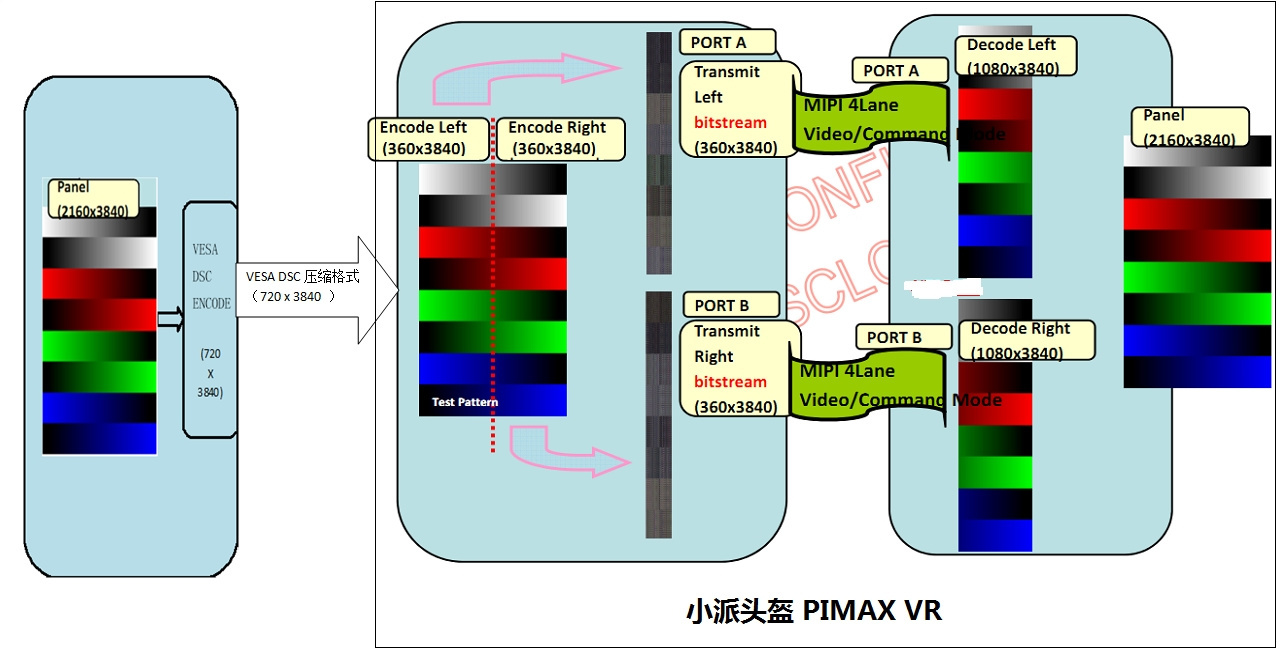

Actually, it also support native 4k resolution by using data compression technology(Qualcomm FBC 2.0 or VESA DSC 1.1), and it works well on android platform. there is the sketch map as follows.
And question arrives, Why not open the native 4k resolution?
The cause is because the graphics card(NVIDIA or AMD)couldn’t support the Qualcomm FBC 2.0 or VESA DSC 1.1 tech. so we have not opened the native 4k resolution until now.
If u are expert on GPU or data compression, please participate in the discussion and try our best to find an valid method to resolve it. thanks.

Great topic ! Too bad to hear Nvidia and AMD dont support DSC 1.1. Just out of curiousity: how would the headset support DSC 1.1 ? Is the SM32F CPU fast enough to decode it, I doubt it ? Or do you have some hardware decoder in it that supports DSC 1.1 decoding ?

yes, the handset has a special hardware GPU processor which could decode the compressed data within 1ms. all done by hardware.

So in theory it should work with ARM FBC?
I think so. But Nvidia and AMD don’t support it.
