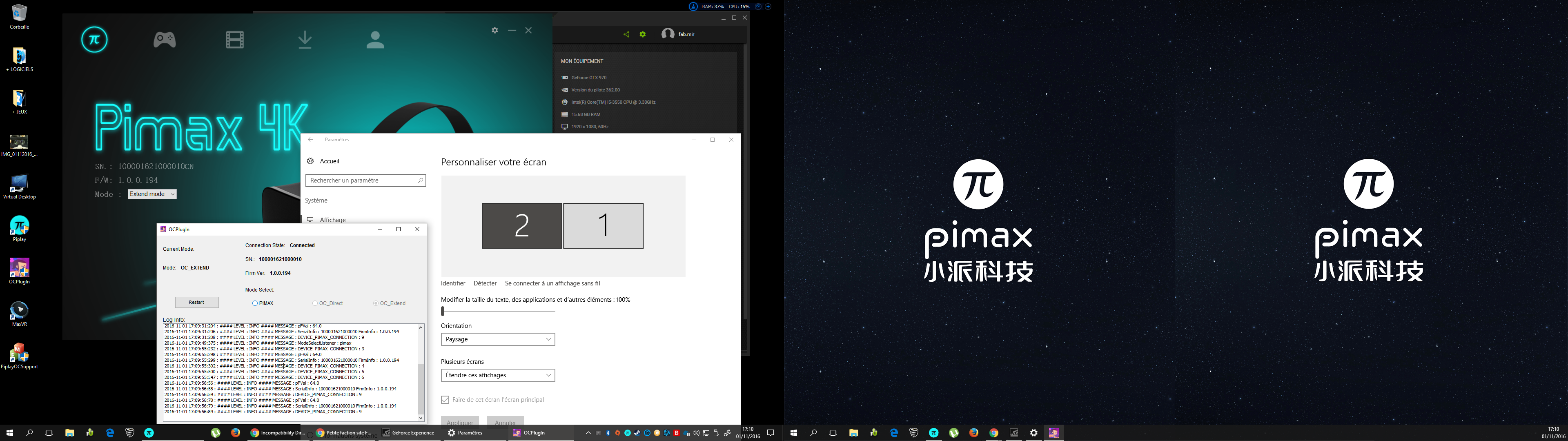

Hello and thank you to you for your help, know that I am French and I use a translator because I find no support and in French I well not have to be the one in this case!
I send you a screen capture of my desk where you can see that I can not seem to get the extended mode to switch to direct mode!
I click several times with OCplugin on live PImax then he handed me systematically extended!

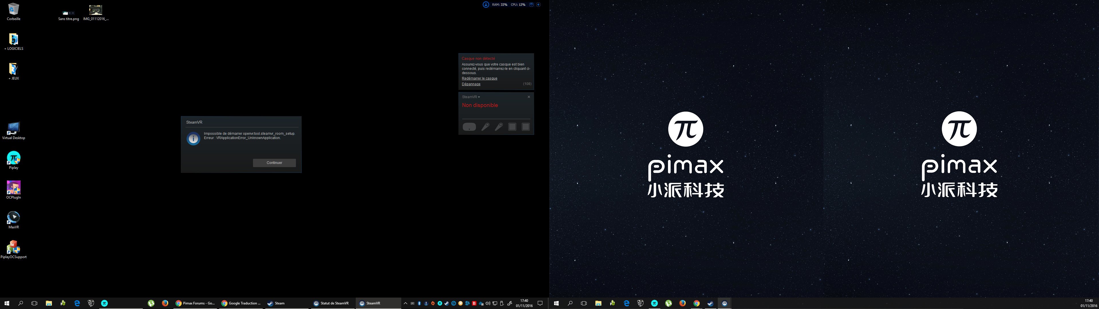

And steam vr :
Can not start “openvr.tool.streamvr_room_setup.”
Error: VRApplicationError_UnknownApplication

Hey mytemplo, before you are able to use DIRECT/PIMAX mode you have to adjust your windows display settings. You MUST use DUPLICATE in your windows display settings. I can see in your screenshot that you do NOT use “duplicate/dupliquer” in your windos display settings.
Your screenshot: “plusieurs ecrans: étendre ces affichages” => this settings are wrong. With your settings you have no chance. Change your windows(!) display settings from extended to duplicate then you will be able to switch in your PiPlay software from EXTENDED to DIRECT/PIMAX. Check this out :slight_smile: That’s how it works on my system.

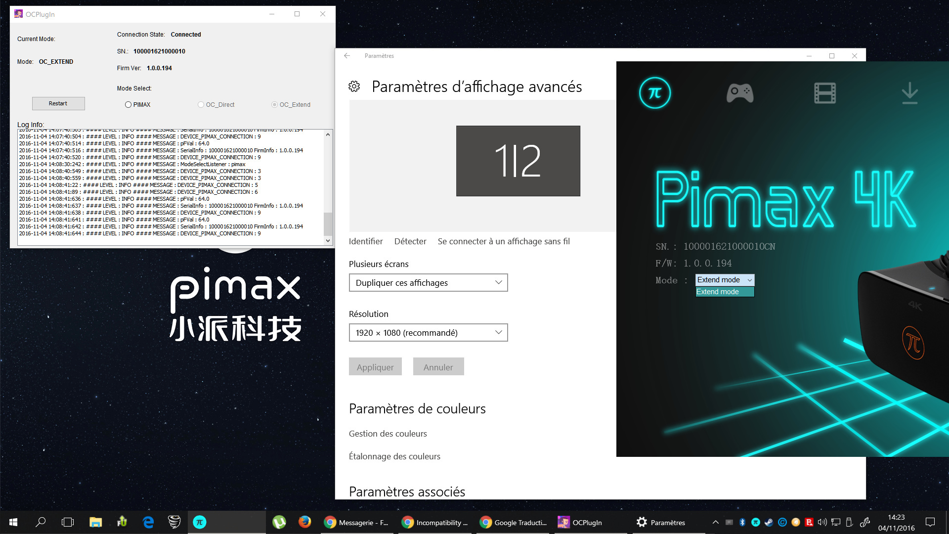

So I have set the displays in “duplicate” Screen 1 and 2, but when I open the PIMAX application, I have only one choice “Extend” mode in the drop-down menu.
Then in a second time, I use OCplugin saw that for some, this had worked, but every time I try to set the mode “PImax” or “direct” mode, after clicking the “restart” the plugin me balance again in “extended” systematically and this directly affects my displaying parameters as they will also automatically switch to extended mode without me even I do it?

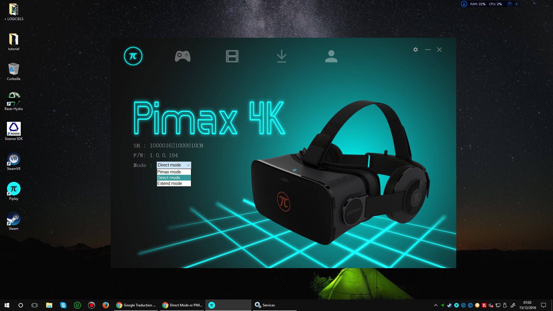

http://community.openmr.ai/t/yes-pimax-mode-is-ok-gtx-970-nvidia-tutorial/794
Thank you very much I finally solved the problem definitively, see the tutorial here!
Hoping this will help a lot of people !!! <3
