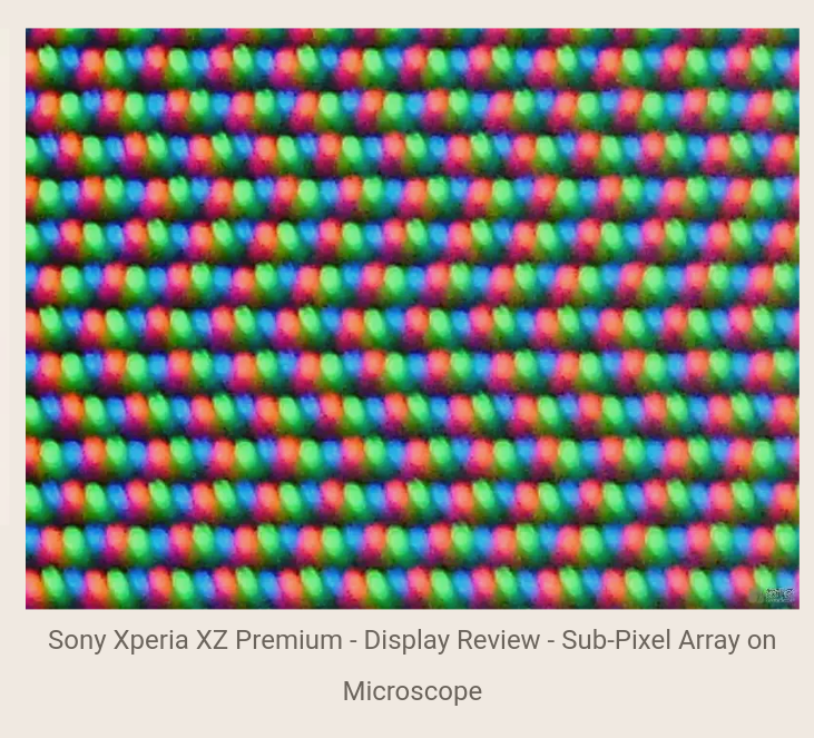

Demostrating Pimax 8k has real RGB subpixels with an 4k panel resolution. And explaining the source of its image problems
No it does and that’s the problem. the ratio of vertical to horizontal pixels doesn’t match if you only go by full RGB pixels. To make the numbers line up you have to take the green sub pixels and count then as whole pixels and you have to take the smaller red/blue subpixel pair and count them as the next adjacent pixel.
This isn’t full RGB which over two pixels would be RGB,RGB it isn’t pentile which over two pixels is RGGB, for two pixels its actually RB,G.
Which is unfortunate.
Edit: I may have confused pentile, may be RBGRB? I think they are supposed to have less green pixels as we are more sensitive to green light but I may be wrong. Either way the point stands about the difference between the 8k and a normal full RGB stripe

Here is one of the 4k panels from sharp
Pixel pattern?
Yes, I would think so. I assume a full-RGB stripe panel became available and Pimax jumped on it. At some point, I would think that a 3840x2160 version of the panel will be available and will be used in some future headset.
I could easily be wrong, but looking at that diagram of the sharp pixel pattern it doesn’t seem to align with the photos at all. The green pixels in the photos all align both vertically and horizontally whereas they go in a zig zag pattern on the sharp panels (like the pimax 4K actually).
Does that mean it isn’t the Sharp 4K panels being used?
Yes, I don’t think that’s the 8K panel.
Hard to say as this was in the 4k.
It was said the new panels from someone that it appears to be rainbow rgb.
This would explain their reluctance to talk about basic specs of the 8K panel and instead replying with vague things like “still tweaking”. I assume they need to shift purchased stock so keeping it quiet. I actually told a mate (who was undecided) a few weeks back they would bring out a 8K+ shortly after selling all the remaining 8K units so he should switch to the 5K+. I think he agreed and switched. But all speculation of course because Pimax are being silent on it! Grrrr
This looks like the sharp panel from the spec sheet.
Definitely not the one in the 8k
