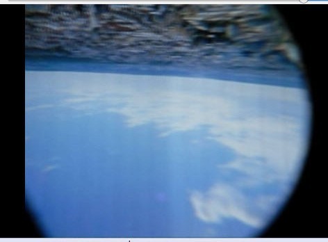

Made a new video:
I put my pimax upside down so my camera fit better.
Try and ignore the sweep that my camera captures and focus on the dark band visible directly in the middle.
This band is most visible when I pan left and right , not so much up and down or not moving.
I did notice that when the defogger activated and went trough its cycle that the dark band was not there but came back as soon as the -regular- defogger lines finally faded.
Now I am hopping it is software or firmware related and not hardware.

Looking at this still, if you look carefully you will notice that besides the darker middle band a lighter one is right next to it !
(I flipped the image right side up)

Your issue is very clear now.
I also have the same effect but it disappears after 1 minute.
I think the screen needs to heat a bit before it is fully functional. In my case.
But I also have another problem. I have pixels blocked on the red color in the right eye.
I’ve had some from the beginning but it seems there are more of it now.
For your problem, have you tried different brightness adjustment?
Like discribe in this post http://community.openmr.ai/t/status-of-brightness-control/751/38
I just have a try. I went back to normal brightness (10033000) and the vertical line problem remained visible but when I switched back to high brightness (10033036), it disappeared.

It does not matter what I use it’s always there.
The problem is not the rendering of the game or video or image, it’s in how the panel reacts to the signal or that the signal to the panel is corrupted (signal from motion of hmd).

No i agree that is a big problem. I would try what Aurel said about brightness.
Click on gear in Piplay. Launch “Debugger Tool” that will open a new window with info on system & device. Near the bottom there is a box to enter commands. I haven’t checked Aurel’s link but i am sure it contains the brightness control syntax.
Hopefully turning up the brightness corrects issue. Otherwise might be a discoloration in lense holder? Or as you said an issue with signal/render.
Hopefully support is monitoring this topic and is talking to their engineers about possible causes & fix.
Thanks for the simplified info, I do want to try the brigntness thing but like I said I played with trying to change the firmware but not successfully, and I had to stop trying, was getting nowhere, now I may be on older firmware but not showing but acting like it is.
“discoloration in lense holder” can’t be that cause it shows up on movement left and right not up and down, and that is where the signal is corrupted, when it gets the signal from the sensors and the image is adjusted accordingly…

Good news!
I have increased the brightness and it helped a lot !
Level 1; was better but not perfect, but I could focus past it and ignore it much better !
level 2; almost perfect, I’d say 90-95% gone !
