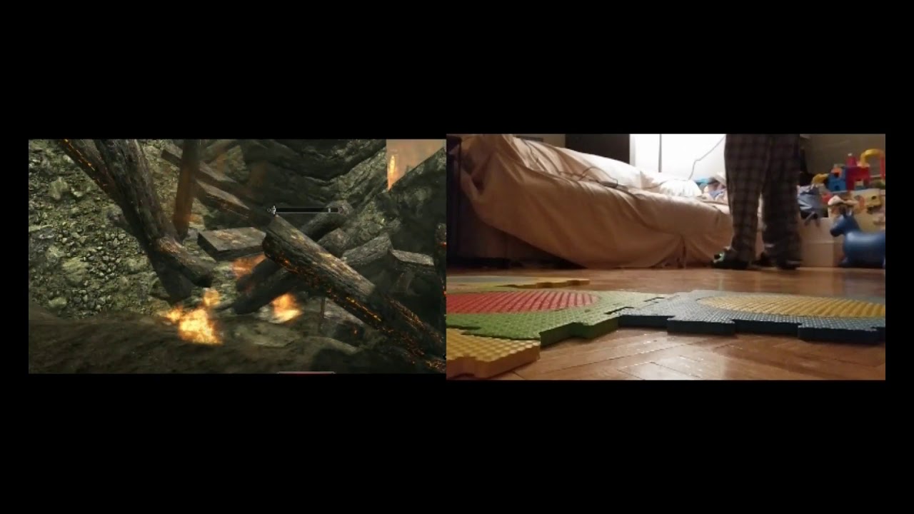

@ziddan I use my own diy shoes for locomotion.
With my shoes i can walk and run in place or walk accross my room , to move foreward. Then i have pressure sensors to move sideways and backwards, standing in 1 location, but i can still move around in room scale if i want.

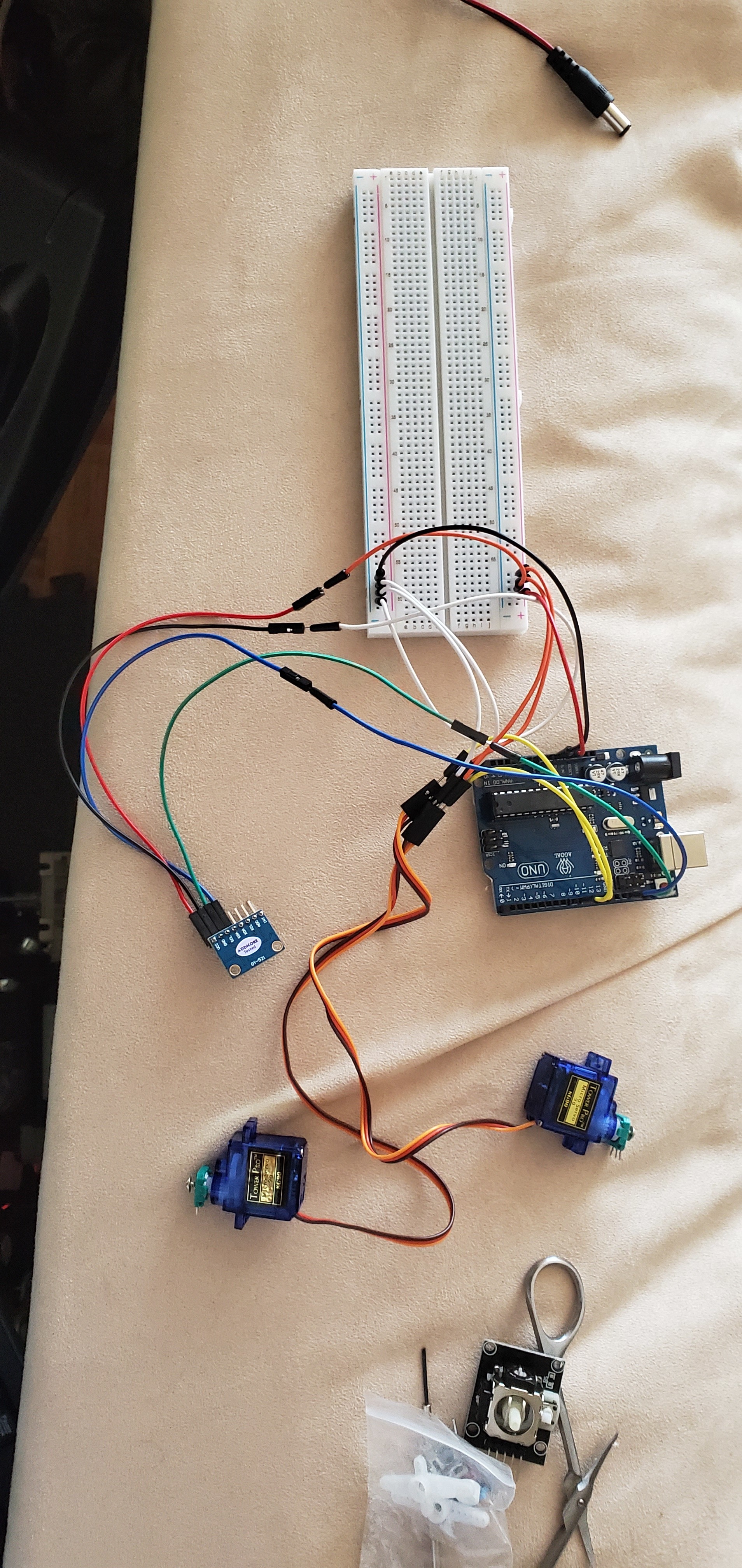

I am experimenting with an arduino and an accelerometer/giroscope , to see if i could mechanically control the joystick of a vr controller , controlling the potentiometer of the joystick
I have ordered a cheap ps3 controller , thanks to the suggestion of @Heliosurge :slight_smile: , that should work with driver4vr
and i will try to mechanically control it with the accelerometer.

Work in progress…
Next step is doing the same for the X axe (right and left movement of the joystick).
Then this hacked controller could work even in vr/steamvr using this method
