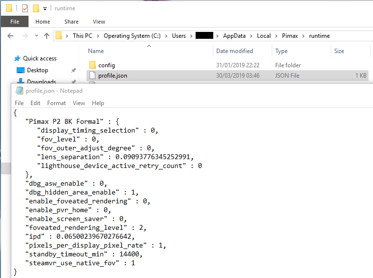

enable screen saver and standby timeout are what you want

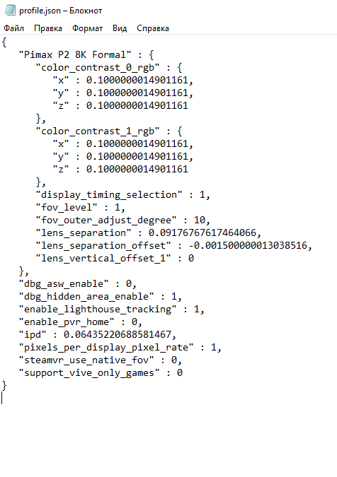

At first it looked like this:
And then I just added these two parameters:
But the panels still off in a few seconds of inactivity (maybe in a minute).
you turn screen saver to 0
Wow, it seems it really began to work!:smiley::smiley:
I changed the value to “0”.
True, it began to work only after rebooting the headset.
But now the panels no longer fall asleep, great
You helped me a lot :beers: :sunglasses: :ok_hand: (Finally, I can watch movies normally)

As a note, I realized I had misspelled the word timeout which was causing my config file not to work, my probelm has been solved
