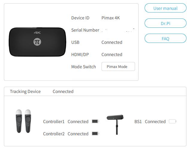

PiPLay detects them perfectly, device icons and all as per image below. Which to me suggests some level of official support.
We never heard anything more about it, though it popped up in the beginning of this year that this package was being sold (but not much outside Asia AFAIK). There were questions if we could buy the controllers separately, for the “normal” P4K owners.
It has “official” support just like the Nolo has I recon.
Agreed, partial support is definitely evident but no ability to calibrate gyro is no good.
