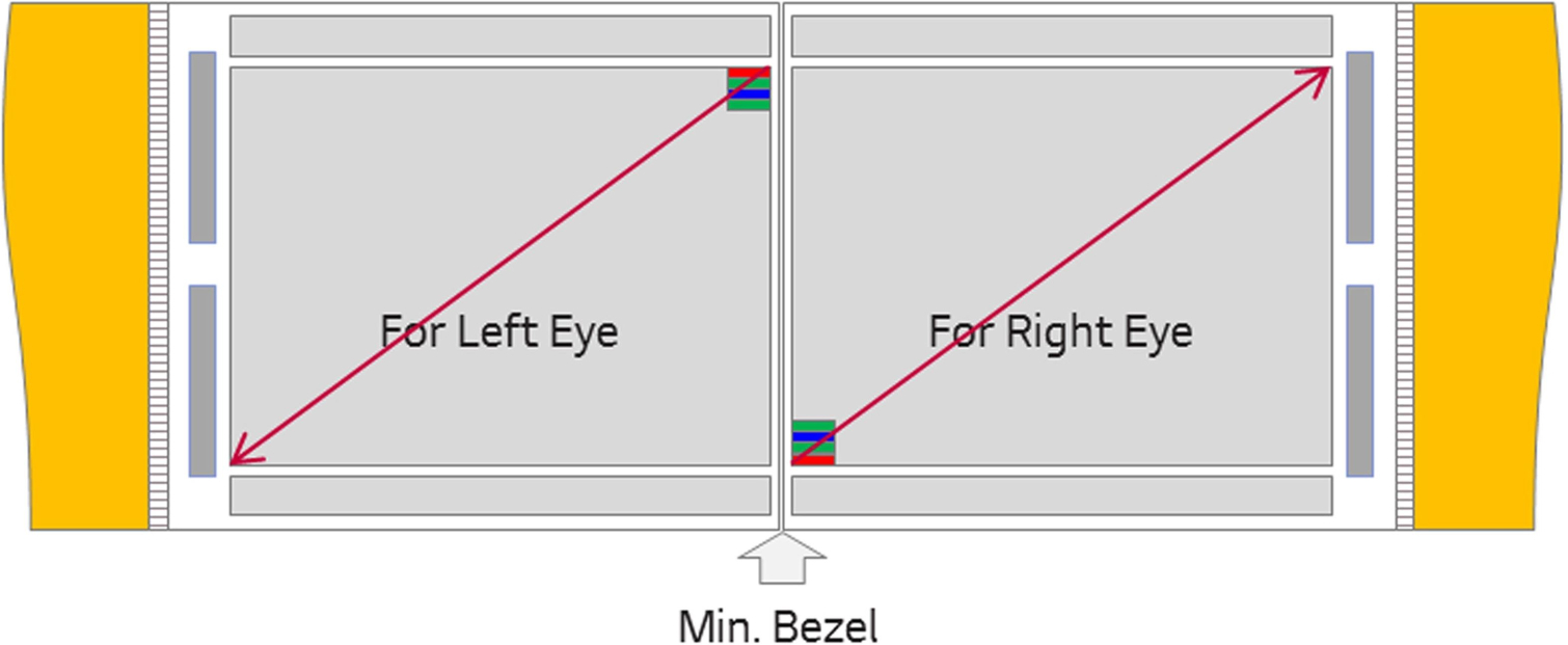

Figure: Pixel arrangement for the upcoming 18mp displays made by Google and LG.

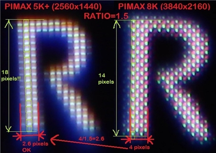

Here’s the 5k vs 8k pixel arrangement.

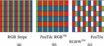

Here’s some different pixel arrangements.
As you can see, the panel on the 8K is some form of RGBG pentile or RGBW pentile screen, due to the alternating pixel arrangement on the 8k from the red pixels appearing diagnonally below in adjacent columns. But according to Google and LG, this type of pixel arrangement is necessary to achieve higher pixel dense screens. So everyone should settle down about it, it’s likely going to be the norm no matter which manufacturer you buy from going into the future.
I don’t see any indications of W pixels in the close up shots. Nor any other type of PenTile. It just looks like a weird offset RGB layout, which I don’t think is great nor terrible.
Pentile screens look like they might be necessary for higher resolution screens though.
I can understand why people might be upset when the 5k has 3 sub pixels per resolution pixel (true RGB) compared to the 1.5 subpixels per pixels on the 8k (1 true green 1 half red 1 half blue), but if the panels in the 8k are actually 2x 3840×2160, this might have just been necessary.
There’s been lack of clarity regarding whether the panel for each eye on the 8k are 2,560 x 1,440 in resolution or a 3840x2160 panel for each eye, upscaling a 1440p signal
