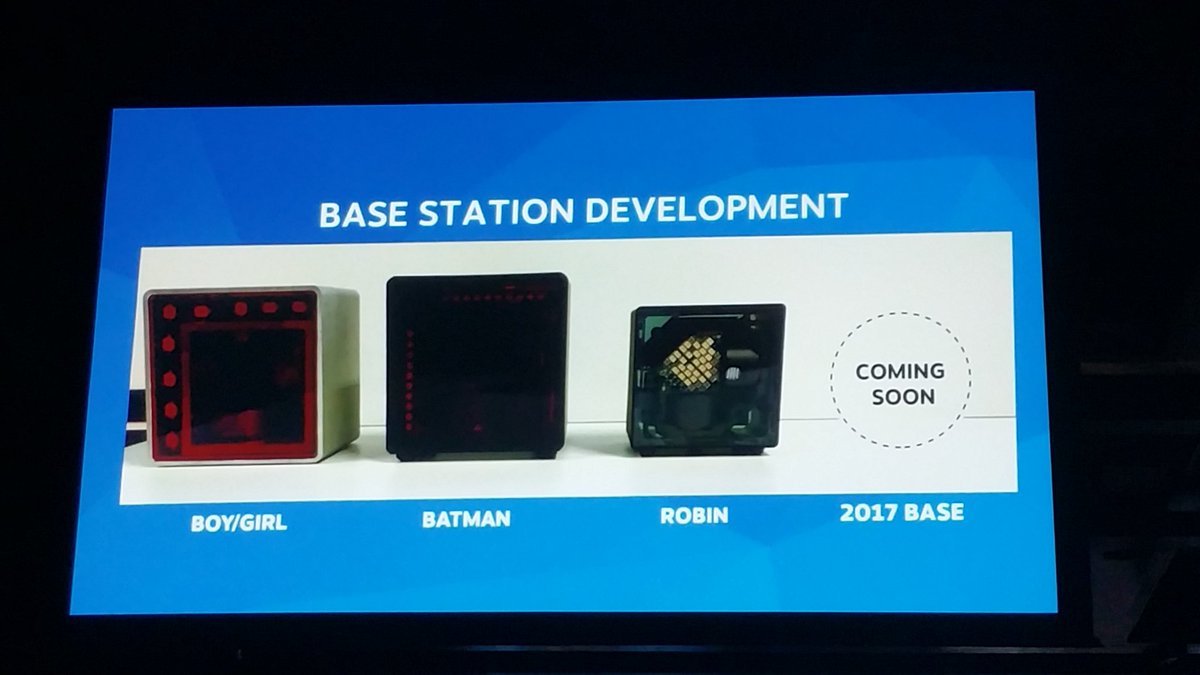

Do I need to pair the pimax to the (robin) lighthouses/base stations? How do I do that?
They work they are identical and there is no pairing, no bluetooth in the old lighthouses.
edit, I thought you meant the vive pre, the older lighthouses should still work though but I have no proof of that.
seems like the robin is just the preceding lighthouse design which the Vive pre used.
