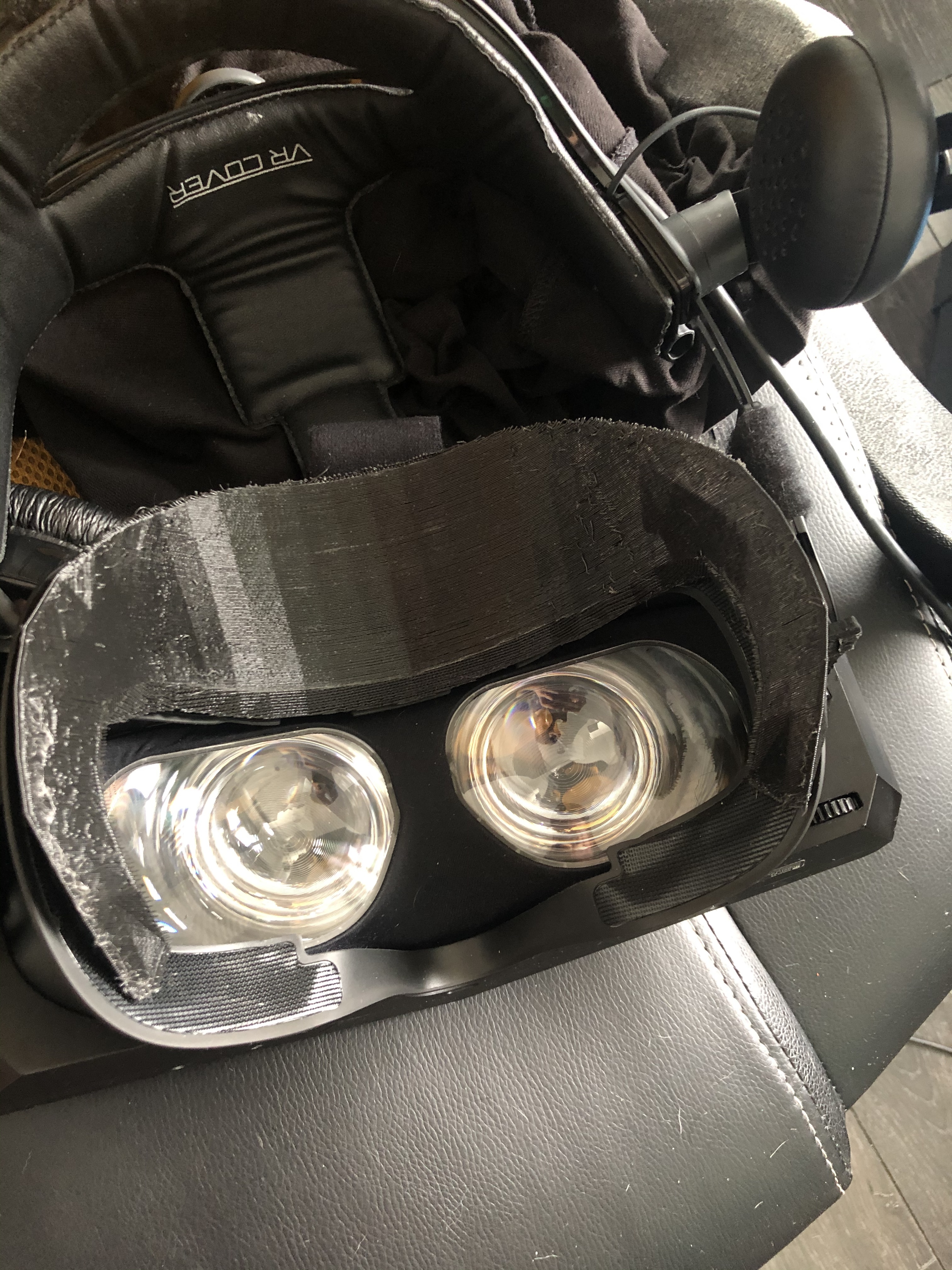

I had to mod my comfort kit to achieve 1cm more distance to the lens, but it’s a game changer for me.
@Yen
Interesting, I was pondering a 3D print which enables adjustment of the “eye to lens” distance. But I will not receive my comfort kit before my 8K X’s are shipped unfortunately.
Any chance we can see a picture of your mod ? :slightly_smiling_face:
Of course!!
Doesnt that extra centimeter make your field of view a lot narrower as compared with the default original face gasket?
Yes!! 5% less FOV but 100% less distortion and absolutely nothing of glare.
