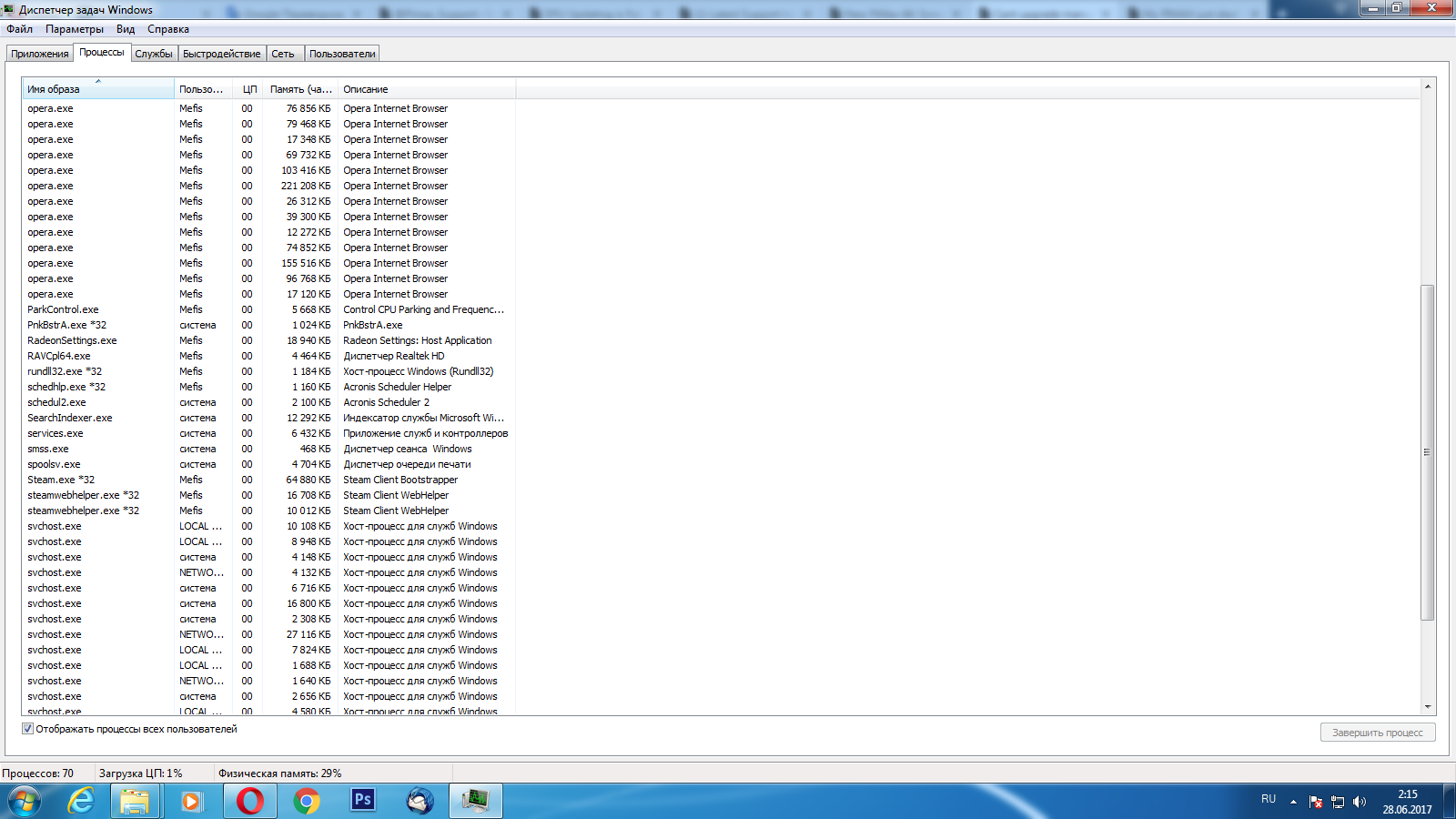

Alhough then again, I’m assuming that the heavy blinking means you’re in DFU mode already. Did you kill all the services like described here ?
“Remember to kill your piservicestarter.exe, piservice.exe and piserver.exe before running the flasher tool !! Otherwise it won’t work.”
Yes, I killed all processes

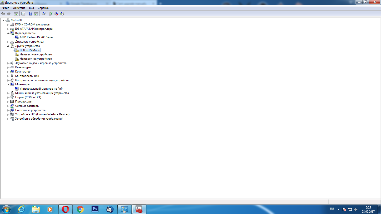

The PC writes that in the mode of VFD, but there are no drivers

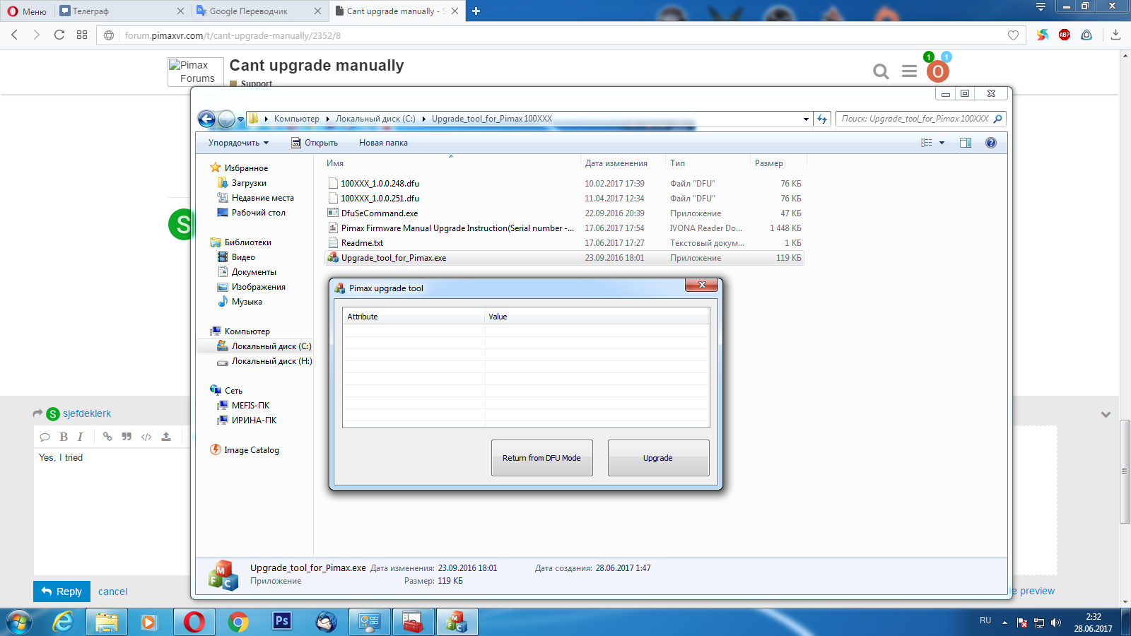

Hmm “DFU in FS mode” I don’t think I’ve seen that before. Did you try the official Pimax flasher tool ? With the official tool it’s very important that there are just regular western characters in the directory name and no spaces. I suggest to just make a directory and name it:
C:\pimax
and then extract the official flasher tool to that directory.
If nothing works maybe @PIMAX-Support can help out
Yes, I tried
thanks for the help, Write support…
I see a space in the directory name. That’s a 100% guarantee it will NOT work.
Rename it to C:\pimax
I tried, without results
