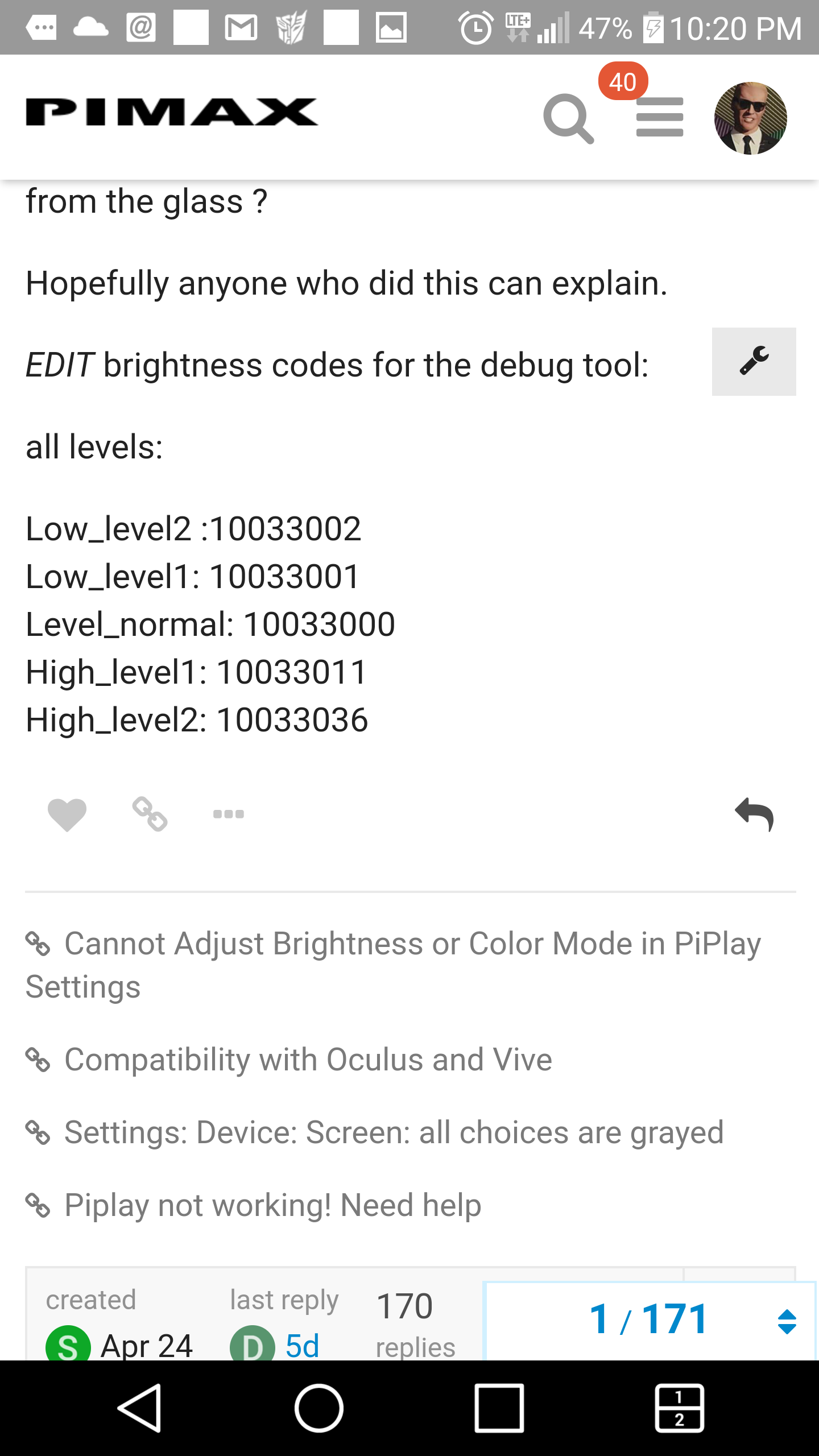

These options are currently disable & will return in a future update. I presume your using latest version 1.2.75
Search brightness you can still enter debug codes to change brightness.

I’ve recently contacted pimax support about the same thing. If you just bought one recently like I did, check your serial number on the bottom of the hmd. If it starts with “102xxx etc” like mine, it’s a newer batch and they have disabled the ability to adjust the brightness, as they can optimize it better in code (from previous users’ feedback) Support mentioned it was already a good brightness set by users’ feedback, but I asked him to consider that it will not be acceptable for many users (like myself), and they should allow users to set the brightness from the lowest to the very highest.
With these 102 headsets, setting the brightness manually with the debug tool will not work unfortunately. :frowning:

Well, I’ve changed the brightness level to the maximum in the debug tool and it doesn’t seem very different. Is there a previous version of the pimax software that lets me control these features? Thanks for your help :slight_smile:
By the looks of what @Lucied said if your serial begins 102 maybe not.
