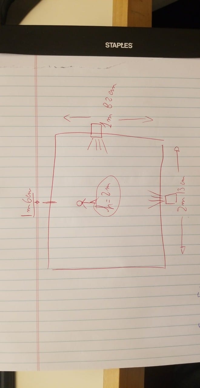

My room space would be set up this way
I am not sure if the nvidia surround would work for me with that shaped play area I have
