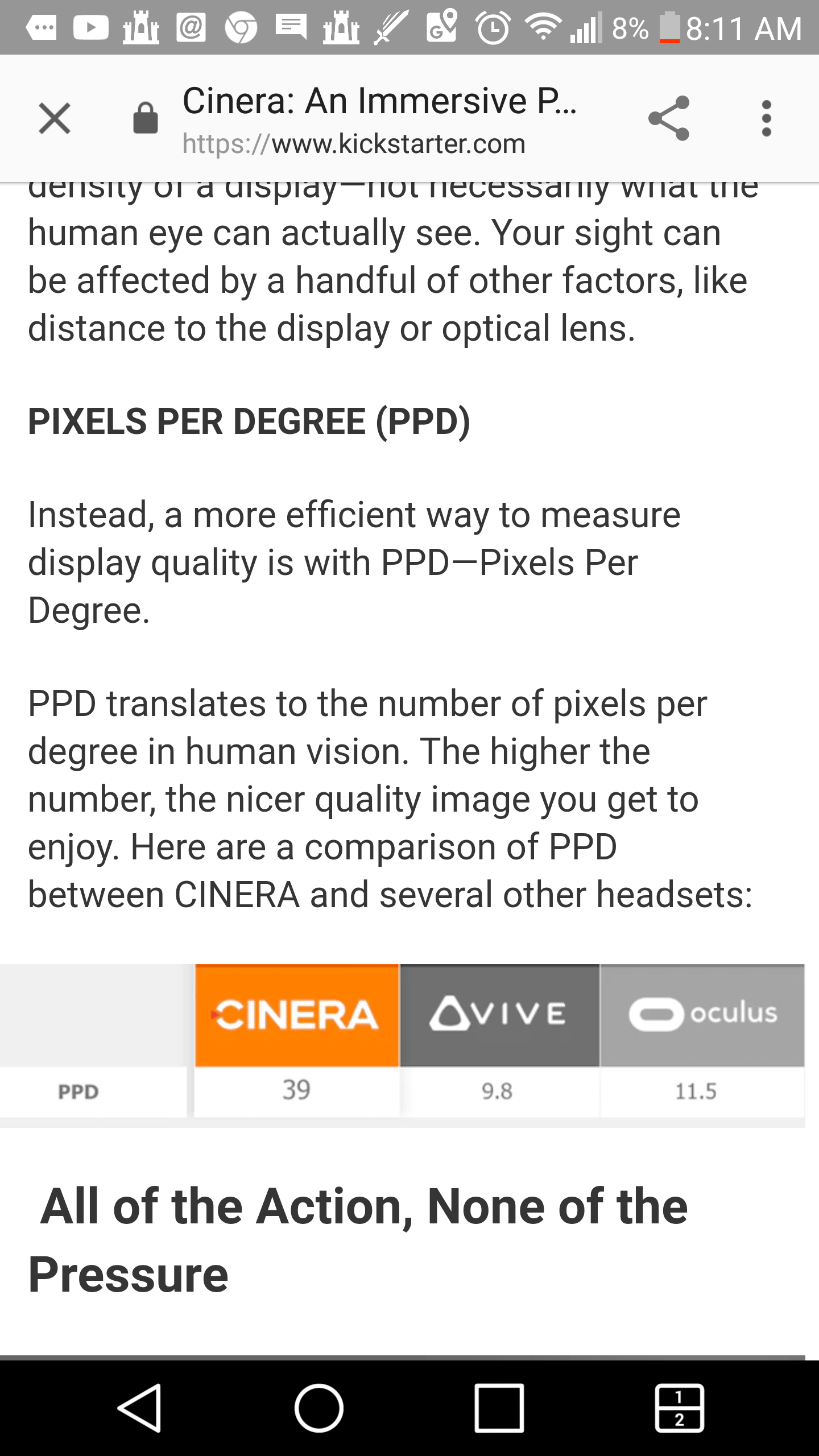

I am by no means an expert in this field, but my own method of determining resolution image quality (Pixels Per Degree or PPD in this case) is to divide the number of horizontal pixels of one of the screens by the number of degrees in the FOV:
Here are my results (the maximum amount of detail a person can resolve with regular 20/20 vision works out at about 58 PPD):
Cinera: 2560/66˚ = 38.78 PPD (Cinera round it up to 39PPD in their own marketing materials)
Pimax 8K: 3840/200˚ = 19.2 PPD
Therefore, my conclusion is that, for the purposes of watching movies, the Cinera is able to concentrate approximately double the number of pixels into the 66˚ POV area which the movie is actually presented on, which apparently represents approx 95% of the total screen area on the Cinera.
Obviously, the PIMAX 8K boasts the highest overall resolution on the screen, but it is designed to fill your entire peripheral view with those pixels for an immersive VR experience, not optimise them to fit in a rectangular movie screen.
Here is an excerpt from Cinera’s campaign marketing material which explains the differentiation between PPI and PPD:
More Pixels, More Quality . . . Or Not?
You probably have heard of PPI, or Pixels Per Inch. (Most of us became familiar with the term thanks to Apple’ retina display.)
While PPI can be a helpful stat, it doesn’t tell the entire store. PPI only illustrates the pixel density of a display—not necessarily what the human eye can actually see. Your sight can be affected by a handful of other factors, like distance to the display or optical lens.
PIXELS PER DEGREE (PPD)
Instead, a more efficient way to measure display quality is with PPD—Pixels Per Degree.
PPD translates to the number of pixels per degree in human vision. The higher the number, the nicer quality image you get to enjoy.
