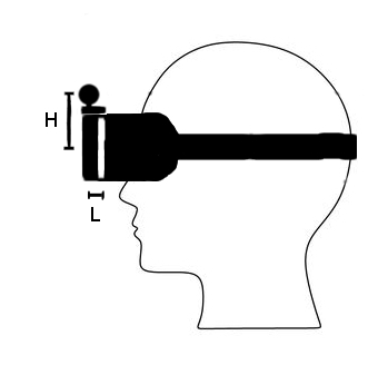

My idea is to use the original compensation but this time in a custom way, since the position of the Nolo headtracker on the hmd varies according to its shape. Doing it based on the height and length of the position difference between the headtracking ball and the center of screen (something like in the image below) and these measures can be changed in boxes within Piplay. all this would allow that the headtracker could be placed where each user finds more comfortable depending where it has the basestation, even just above the head for those who have the basestation in the ceiling.

@Virtualreality Thanks for your good suggestion.
We will discuss the feasibility of customizing the position of headtracker (headset marker) on the headset with Nolo side.
