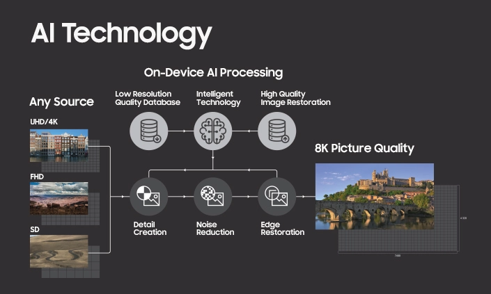

The noise effect I was referring too is with pre-rendered animated textures, there is noise in there that is random from frame to frame. (We attempt to remove it using a denoiser pass, e.g. NVidia or Vray’s) Supersampling can make it more obvious. This is the Crux of the problem in the TV world, SD video when they try to scale it to HD enhances all the crap like compression artifacts, edge crawl, hallowing etc. So yes, I see your point of a softening pass which is what I imagine Samsung do at the edge detection part where they sharpen the softened pass.
Noise reduction which attempts a softening also softens the entire image and you get a kind of block crawl effect with that too so it needs to be more precise.
Samsung Q9S have tried to improve scaling with an AI engine that one day we can hope will appear in HMD’s.
