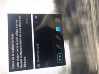

Well, I did not give up and I finally managed to update this base 2.0. See picture attached, steamvr prevent to return base station to factory
So It was necessary for succes :
  • Bluetooth link (I bought a dongle just now)
    -Pair W10 with base (FCC ID as password)
    -A USB link with the base
  • Steam open with a Vive or Vivepro headset (for Bluetooth menu access allowed in steamvr)
  • Connect power cable of the base While pressing the hidden channel config button (all lights disapear on the base station)
    And then the update started in steamvr and is done in 5min depending on internet connection
    However, even if update reach 100%, the firmware update appears incomplete, but on the base the indicator has gone from white to green
    Restart everything And the alert disapear in Steamvr
    Well not sure all steps are compulsory but after 1 hundreds ways of tryings, this is the only way it worked for me.
    Main problem is that without a Vive helmet there is no way (for me) to access to bluetooth enable possibility)
Sorry for my poor english

EAfter another try with a vivepro, steamvr and the new base now lighting green, here is what i get, finally same alert message than with the white light on the station
« This base station has a factory default, contact builder for a change »
I guess game is over for the valve package received from pimax (controllers and bases 2.0)
