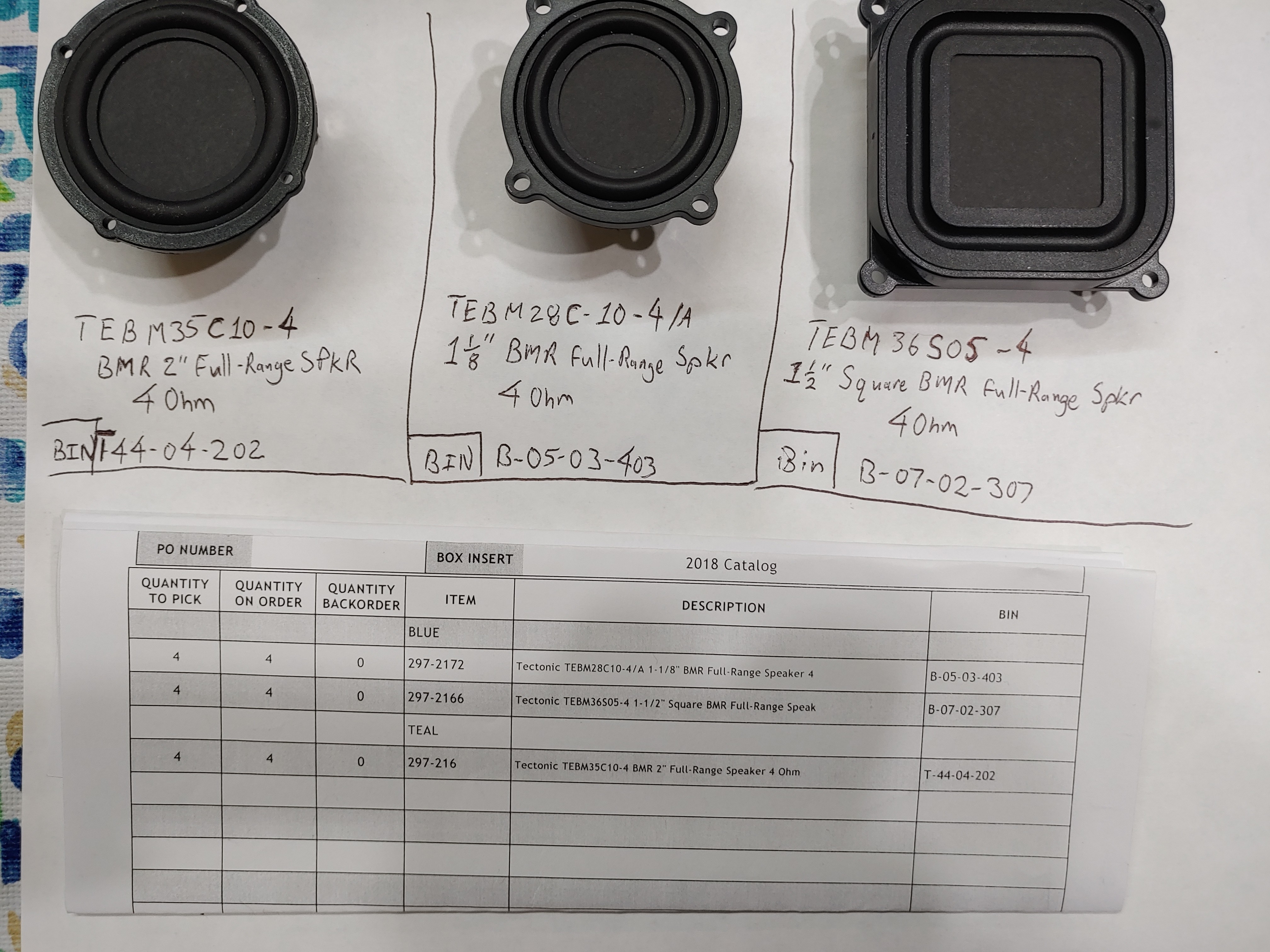

Here is the 3 types of BMR 4 Ohm speakers I ordered. The first one on Left is the Valve Index ones mentioned in the Oculus reddit thread mentioned.
I ordered 3 kinds 2 pairs of each to make shipping cost more worth it.
Not sure when I will dive back in. All have similar specs. The middle is smaller and might be interesting as such to use in a build. The Square driver I think could also give some nice results in an off/near on with & Without pads.
