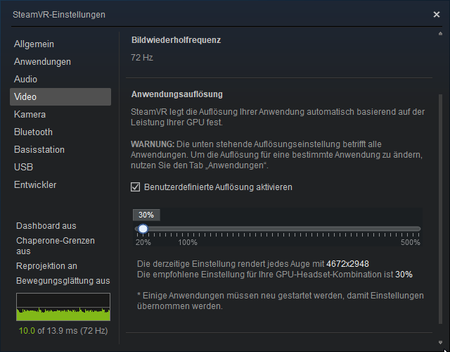

It is like you said. It starts detecting GPU Speeds - adds them up and does the average on each start. It’s rewriting my config in E:\Program Files (x86)\Steam\config each time.
That taken into account is used to set the ā€œsupersampleScaleā€ : 0.30000001192092896 as an example
This is also visible in the menus right here:
grafik
I can fool it into thinking better but each start does an average and goes near to what it believes is the value for my GPU (2080TI).
Even though its the path where I should be editing my config
Edit: If you open the config file with a good editor (that auto updates) then you can see the slider in steam live changing the values in the config file.
Do you have the ā€œauto-adjustā€ feature enabled? From the screenshot it looks it is disabled (Benutzerdefinierte Auflƶsung aktivirien), or did you just disabled it to get the readings? If you want to set the SS factor to the fixed value, you need to disable it and set it manually.

@risa2000 if I uncheck that box, then I don’t have an option to set the values - so checking enables setting it by hand in the steam many and I thought that would be correct? Do I need to uncheck and then set it in the config?
( it says above that steam will Serbia automatically and then the checkbox seems to opt in on manually setting it. None the less having it checked resets the value each startup as it queries the GPU speed and the adjusts accordingly the Supersampling.
You should have it checked, and set the value manually. If SteamVR rewrites the file even then, then I would expect that this file does not actually apply.
That seems to be the case.
It’s checked - moving the slider Alters the config immediately. But it does Alter does values every start up. I noticed because on first try my resolution was equal to the examples mentioned above for 5k but changed.
That’s why I tried all possibilities- only the ā€ždon’t editā€œ default file keeps its values. I thought I had noticed this before and only the one in the user appdata file would do the job - but there is no config and it’s not mentioned by the vrpathreg.exe file
