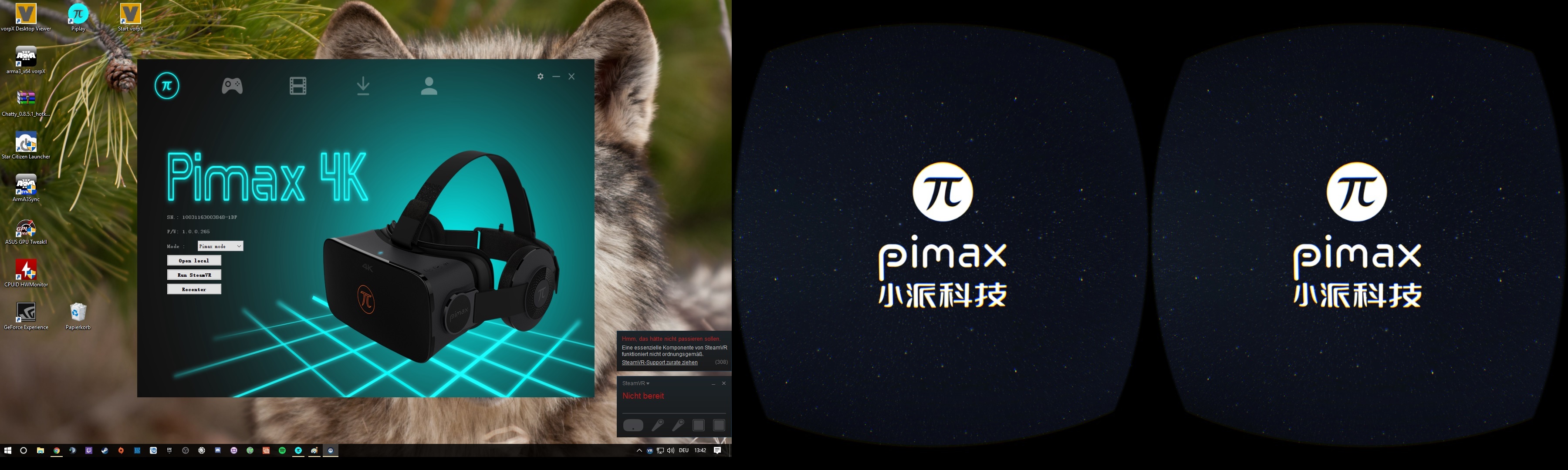

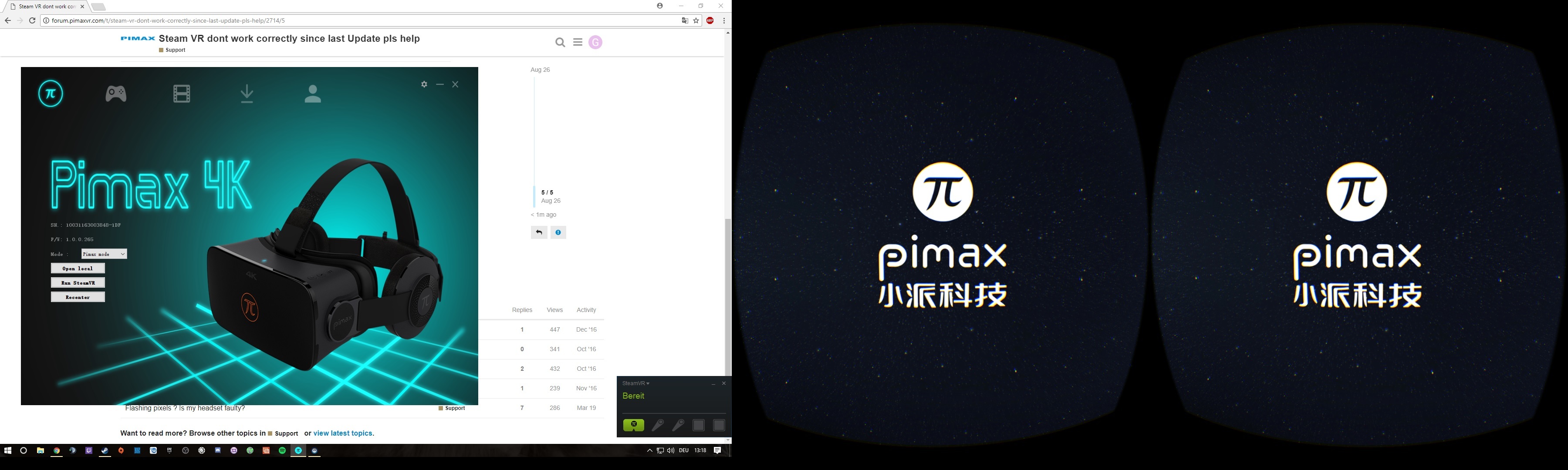

if i restart my pc i can start Piplay and steam vr normal but it should show this gray net in my pimax but it keeb showing me this logo if i try to start a game :
oh its german xD (308 says VR headset has no signal)
