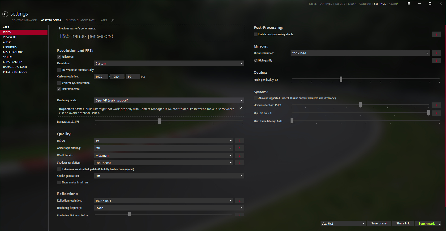

AC is pretty much a flawless experience for me. I run these settings with 120hz, large fov, pitool 1.0 and steamSS @ 140%
Setting LOD bias to -1 gave me a cleaner look but gave me a lot of eye strain so I turned it off.
In nvidia control panel, i have MFAA enabled and AF set to 16x. LOD bias = clamp.
Thanks for these, got a few different settings from yours so I’ll have a play around :+1:
