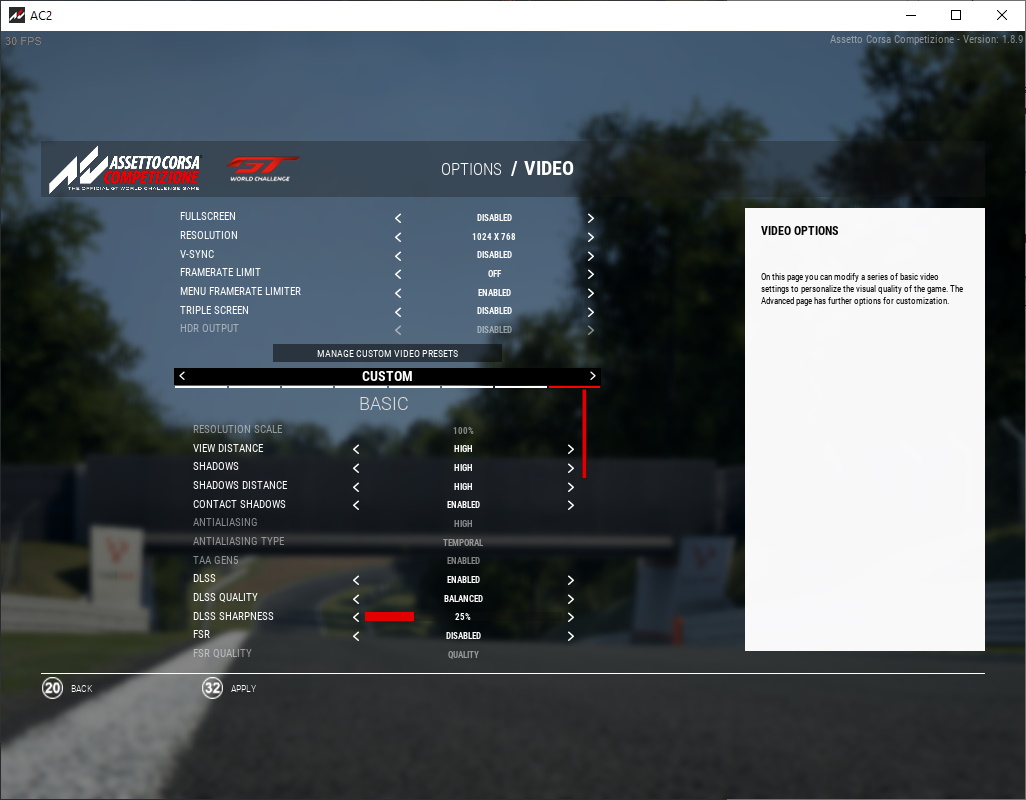

Here are my exact in game settings. No i dont use any custom ini tweaks. The game was fresh installed since the V1.8 update to rule out anything old leftover from the ini file.
In pitool I use normal FOV, ācompatible with PP=OFFā, FFR=Balanced, Quality=1.25, Smart Smoothing=OFF and STEAMVR res scale = 100%.
Nvidia driver version 497.29, but it worked the same on 496.76 as well.
Pixel density in game is 115%, any lower and it starts to get blurry; any higher and my pc struggles too much to keep high framerate required for VR. This is using the Pimax 5k+ and my pc specs are Ryzen 5900X, 32gb 4600mhz B-die ram & 3090FE.
For me DLSS works pretty well, its sharp compared to what it used to be but it also gets rid of the specular aliasing which is otherwise quite bad in ACC. It doesnt have ghosting of the mirrors like TAA does. It gives better anti aliasing than KTAA but it does have some ghosting behind other cars, particularly when they are further away but it is very typical of DLSS behaviour as most other games which use it. Hopfully this ghosting will get reduced even further as it improves, just as it did from DLSS V2.0 to 2.3 for games like death stranding for example.
Final note: As mentioned before, do not use āadvanced sharpen filterā with DLSS otherwise it causes horrible tree LODs. Just use the DLSS sharpening by its self if you want sharpening.
