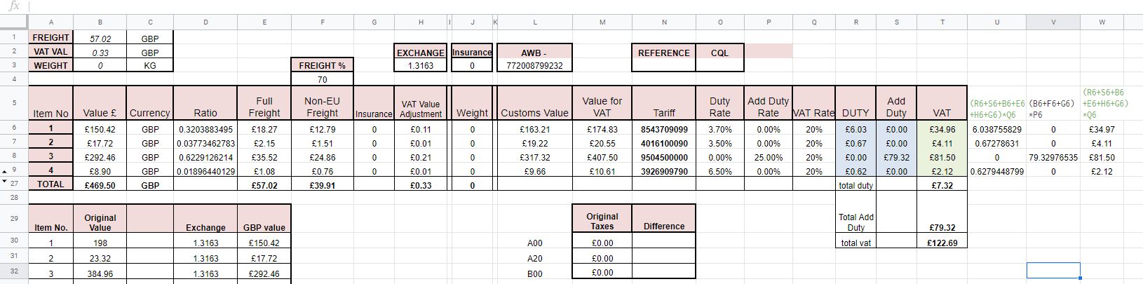

FedEx emailed me a breakdown sheet of the charges.
Very confusing as everything looks so mixed up and hard to track, and even though I had 6 items listed, there were only 4 in this breakdown. Seems either Pimax or FedEx grouped some of items as one.
Anyway after copying the values from the breakdown into an excel spreadsheet.
I tried to see if the figures added up to the final charges FedEx gave me.
And in a way they did.
BUT they forgot one VERY important thing!
They calculated ALL the charges using the DOLLAR value!
They then slapped a £ in front of this dollar figure!
THEY DID NOT CONVERT TO GBP!!!
As they exchange rate used on my sheet is 1.3163
That’s an EXTRA 30% we are paying in taxes!!!
So my 2 backer boxes, with base station and eye tracking FedEx is charging me £221.31 of which
Advancement Fee = £12
Duty = £86.64
VAT = £122.67
Again these figures were calculated using the Dollar figures,
So really with the exchange rate it should be
Duty = £65.82
VAT = £93.19
Ad Fee still £12
So instead of £221.31 I SHOULD be paying £171.01

Here’s the spreadsheet FedEx sent me
2 backer boxes so each is doubled
Item 1 = Eye Tracking
Item 2 = Comfort Kit
Item 3 = Modular Audio Head Strap + 2 Base Stations
Item 4 = Facial Foam + Silicone Protective Sleeve
