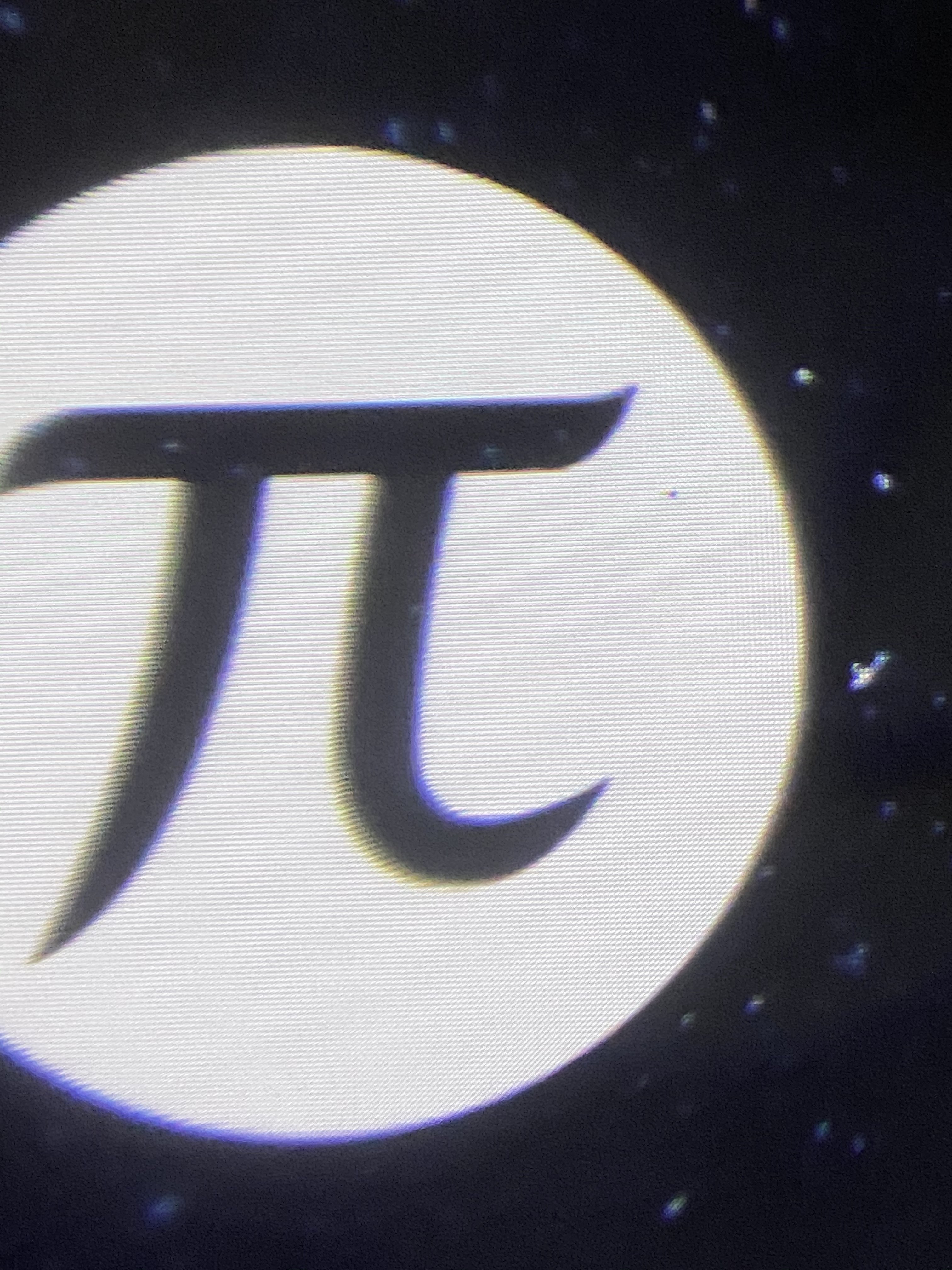

anyone else get their Artisan with a stuck pixel? any tips or tricks on how to get that un stuck? its less than a week old (waiting for base stations to set it up) and just set up to find this thing there, its VERY annoying as its right in the middle of the sweet spot for me, i have put in a RMA request and all that has been said is an $80 coupon and a silicone sleeve… I love this headset just im very very disappointed to see a stuck pixel on it on the first day of use, any and all tips are welcome! Thank you so much for the help in advance! (i have zoomed in on it, the pixel has color to it the LCD black not dead pixel black hence why i said its stuck)

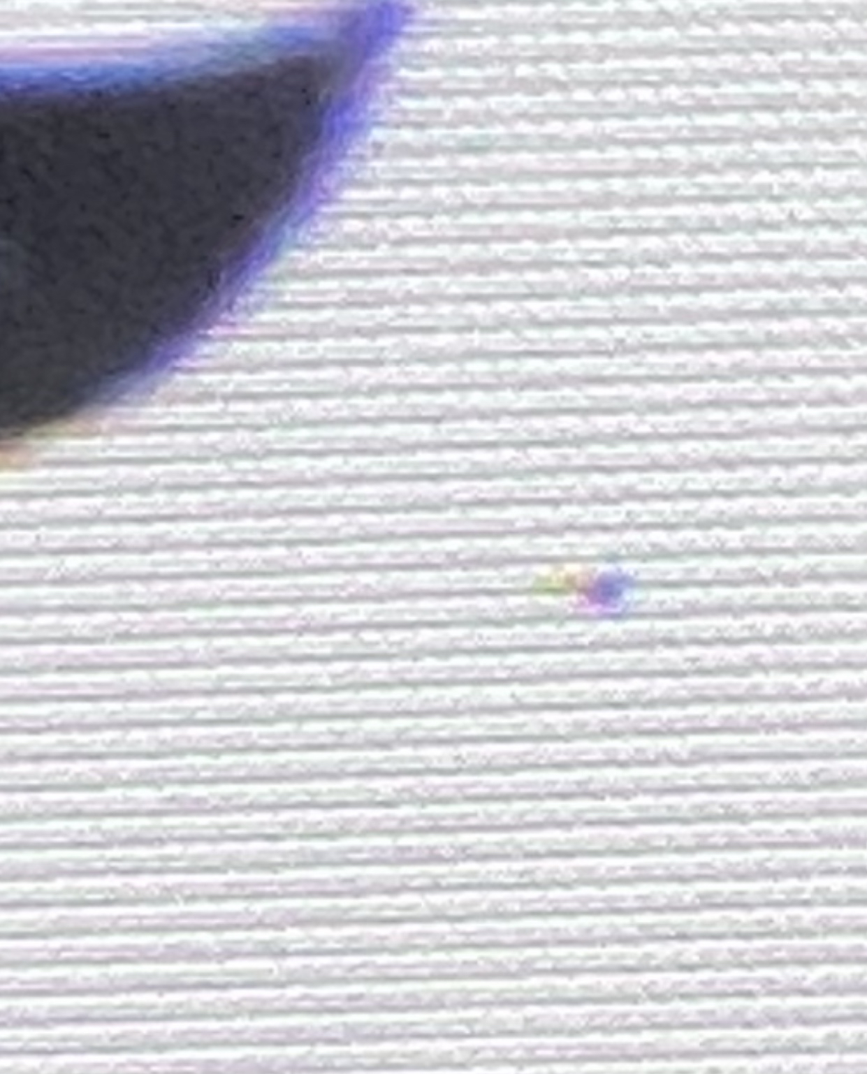

here is a zoomed in picture of that stuck pixel in case you guys needed it!
is it a pixel though? can it be a dust particle? coz on the 2nd screen it seems it covers several pixels partially, it’s why I assumed it, I would try to gently shake a thing or maybe use some compressed air but I guess there are no holes until you dissasemble the HMD
I have checked to see if its dust already and i am saddened to say it is not dust thank you for that input though! ( i have tried the compressed air )

thats sad, i was hoping for it to get RMA as its brand new with very little use time all use on it is fixing that pixel it came with :confused: its spot in the first picture makes it look larger than 1 pixel so hopefully i can try to convince a RMA with it being manufacture fault ( cuz it was out of the box like this )
