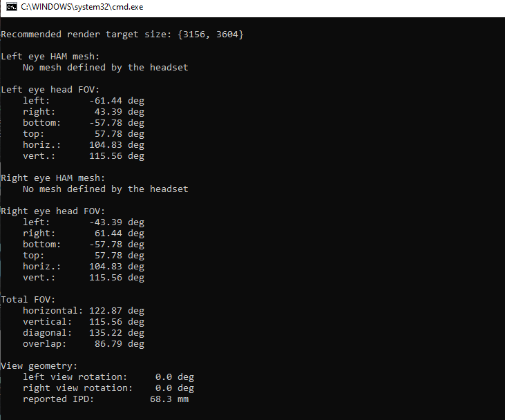

I have some additional data points from Risa’s tool. This is at 90hz normal mode.
Total FOV:
horizontal: 122.87 deg
vertical: 115.56 deg
diagonal 135.22 deg
overlap: 86.79 deg
That horizontal FoV is quite similar to mine (not sure where the small difference comes from but oh well). So it really seems that the latest batches of Artisans are 120-ish wide FoV and the earlier ones up to 130.
