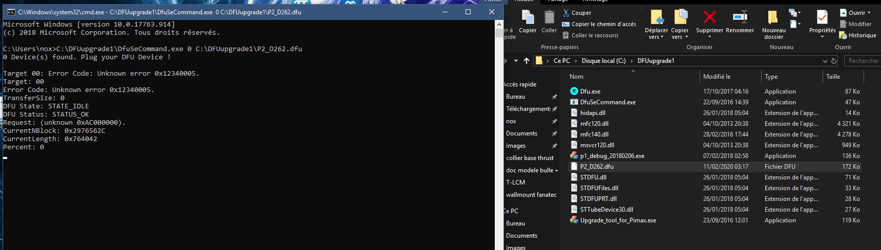

I have the same problem after the update, I can’t get my helmet to work.
I have tried everything, even the procedure explained above.
in the end I had to put everything on another pc to succeed in making a regression.
i find the firmware P2_RELEASE_M264_t20200508200801_r96b28a3
so the hmd works again
but on pitool , he ask me now to make the firmware update and its impossible until to have problem with the artisan
