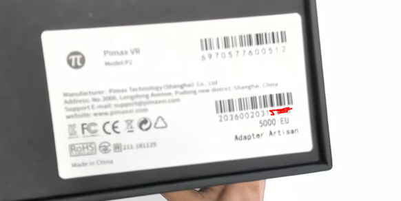

Could you post the first 9 digits of the S/N of your Artisan?
According to this (https://community.openmr.ai/t/replied-how-to-check-sku/15475/12) this should identify the product (6 digits) and the manufacturing week and year, without giving the complete S/N.
@risa2000
Yes already checked this out
sn start by 203600 1 00 so it was manufactured during the first week of this year, I guess.
203600101 my sn _________
@Ludiks @16BIT
thanks for the numbers. What is interesting is that the manufacturing year and week look legit (i. e. fresh built), but product ID 203600 correspond to 5k+ as already confirmed on this forum.
Hi guys, I don’t understand how it works? the year of production is marked as 100 or 101, but because we have 2020, why is there 1, today we got a video from MRTV, and its series has the number 203600 203, how does it work? why 203
@risa2000
