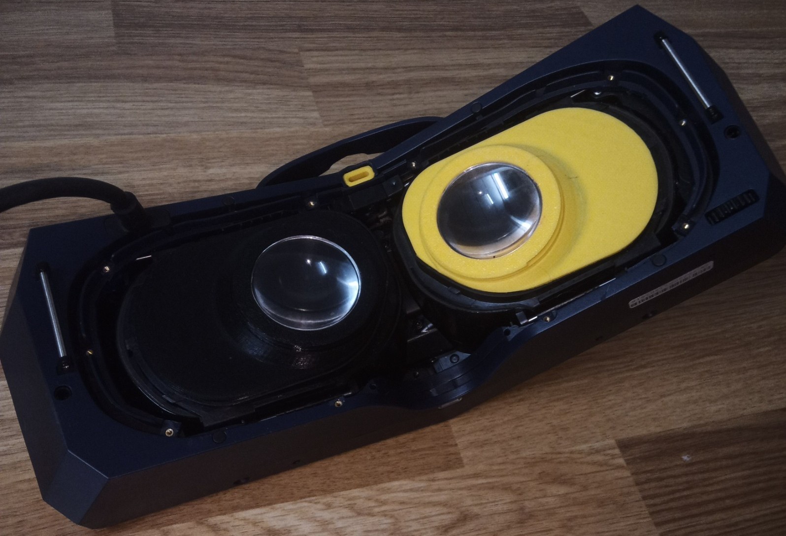

While I’m at it: From the department of silly nonsese:
Here is my coming full circle, with a pair of spare lenses from my Rift DK1, shoehorned into the p8kX :stuck_out_tongue: :
If anybody still believes fresnel lenses are free of chromatic abberration, this is what Pimax puts on screen (seen without lenses):
Ok, now we’re really getting ridiculous:
I will say, though… I am curious what the unholy contraption above would look like, had I matching cameras and distortion compensation to go with it, because those 74mm diameter glass lenses would need huge screens, set into a big bulky box, to fill their FOV (140x140mm panels, for 180x130-ish degrees left and right combined), and since the p8kX panels are not by far that large, that means 4k over a much smaller, letterbox-like FOV – would love to see what the resulting resolution would look like (I dunno - something like 30-40 PPD).
(Oh, and: Hardly any glare. :9)
( EDIT: I mean, I do get the resolution in question, as it is, but the frames are not rendered for it, so they just show up smaller, instead of at the right scale, and with more detail.)
