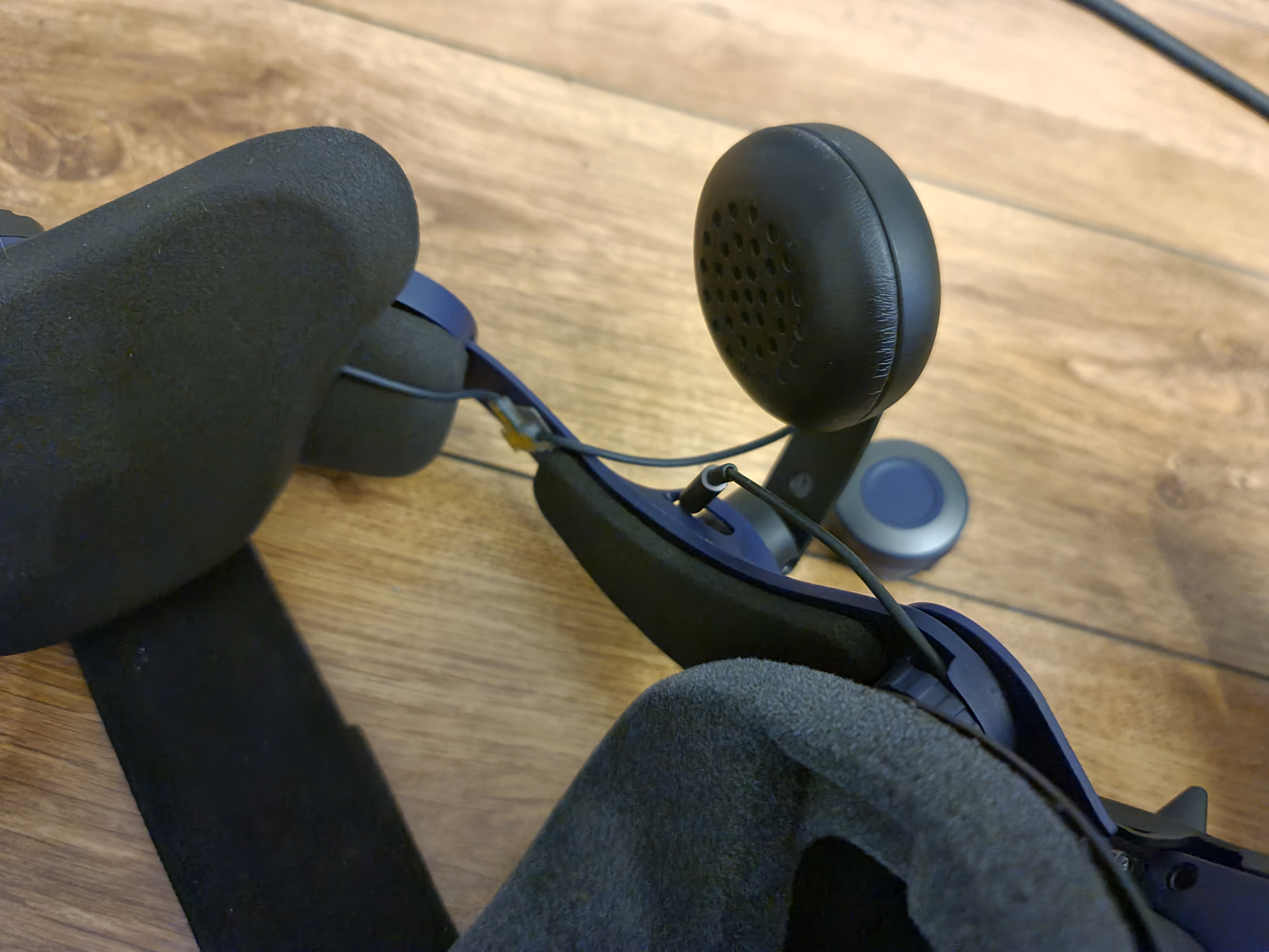

If you have the 3D printed hinges and top strap pieces, first remove the SMAS (the hinges unclip rather easily): Attach the DAS strap to the hinges and then clip them onto the bar. Insert the top strap 3D printed piece and thread the top strap through it. Plug it in and you’re good to go.

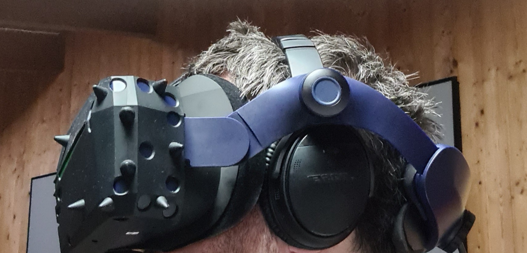

I just played a bit with Koss KPH30i’s.
They fit fine under the SMAS and are good enough for me until I receive the DMAS (I have lots of other headphones).

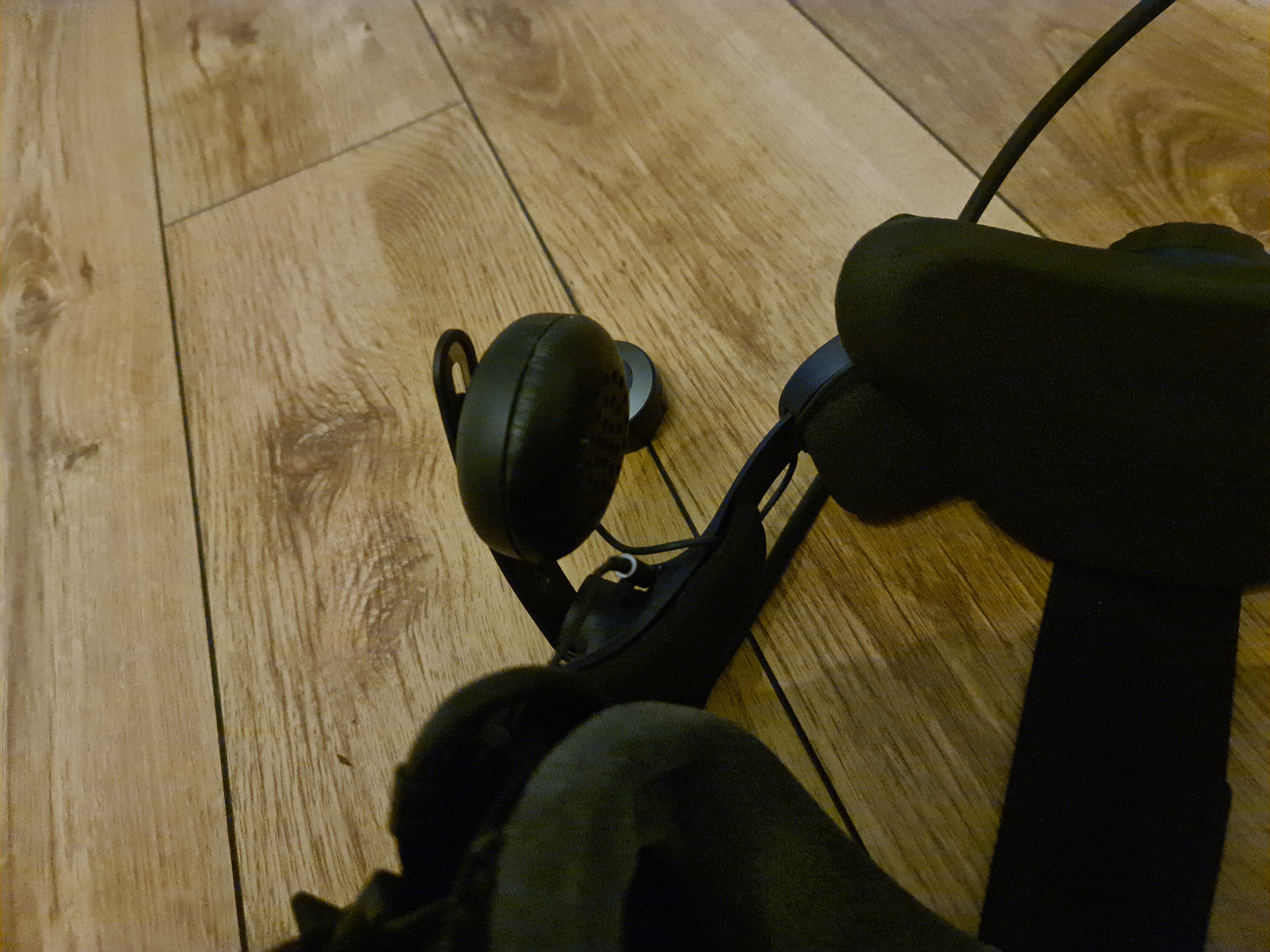

I ended up retrofitting my old vive DAS onto the 8kx because fitting headphones on over top of the comfort kit strap was really uncomfortable. The speaker housings are huge.

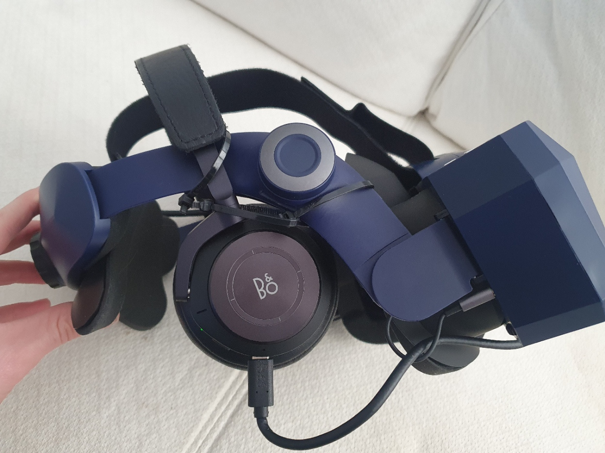

I tried using my Astro A50’s but wasn’t very comfortable, for now my B&O Beoplay H9 are connected to the SMAS using a few zip ties to position them perfectly, and the short right-angled USB C to C cable that came with the useless eye-tracker is perfect to connect the audio wired without any bluetooth lag.

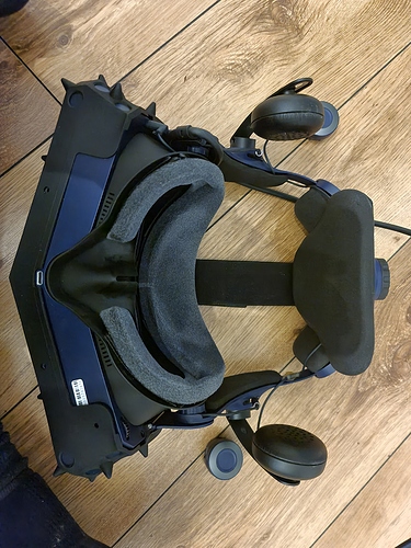

This way it fits very well, and the headset is much more stable on you head
