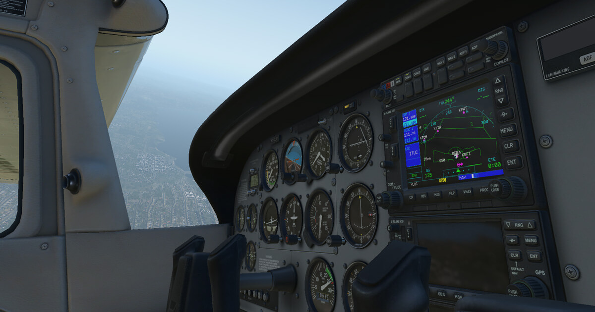

The 8KX AND 8K+ I tried both had extremely readable small text in the Aerofly demo. There was some text inside the cockpit to my left and I was amazed at how well that was readable. And then I tried the 8K+ and it was exactly as easy to read! That convinced me of the quality of the 8K+ too.

Yeah me too, I think you refer to the stiker on the top left of this picture;
I think it was better on the 8KX though, but not by far

Ha yes, that was it. It looked very smooth and it was pretty small text
Yes, I was really impressed by the readability of this text.
Yesterday I installed this simulator and the Cessna at home to try it with my 5K+ and 2080ti. It wasn’t even close.
What surprised me though was that apparently this simulator requires parallel projections to be activated, if it’s true we didn’t see the 8KX at his full potential
