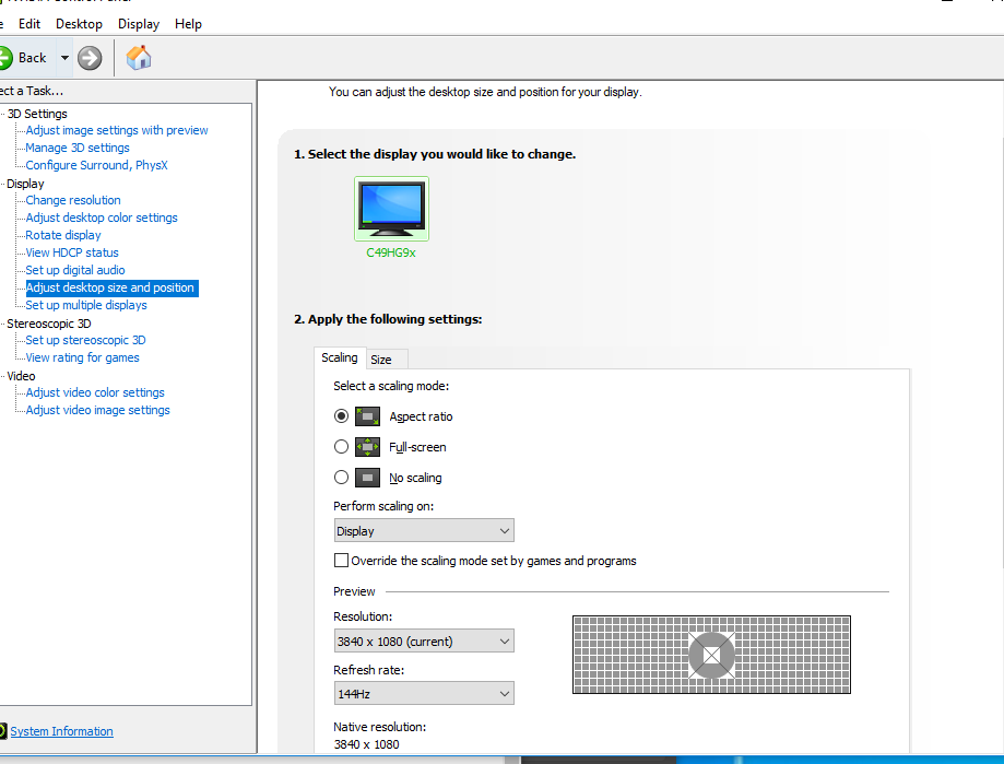

I got this off the Bridge Commander issue thread and gave it a shot with my 8K - it cleared Il2 BoS up no end and the landscape detail improved no end - no blur.
Nvidia Control Panel under Adjust Desktop Size and Position No.2 Apply the Following Settings - Scaling
** Set it to No Scaling where it sets Set a Scaling Mode.**
The default Scaling Mode setting is Aspect Ratio.
Changing this scaling setting has improved image quality through my Headset no end. Landscape clarity and focus, less Aliaising - it is like wiping Vaseline off your lenses.

It works! Some friends have tried it and it seems that the image improves a lot also in the 8K!
There has to be a major bug that makes the Pimax look like a monitor, it should go into direct mode, but the thing is it works, thanks, man!
I recommend everyone to try it.

You have to check “No scaling”, instead of “Aspect Ratio”.

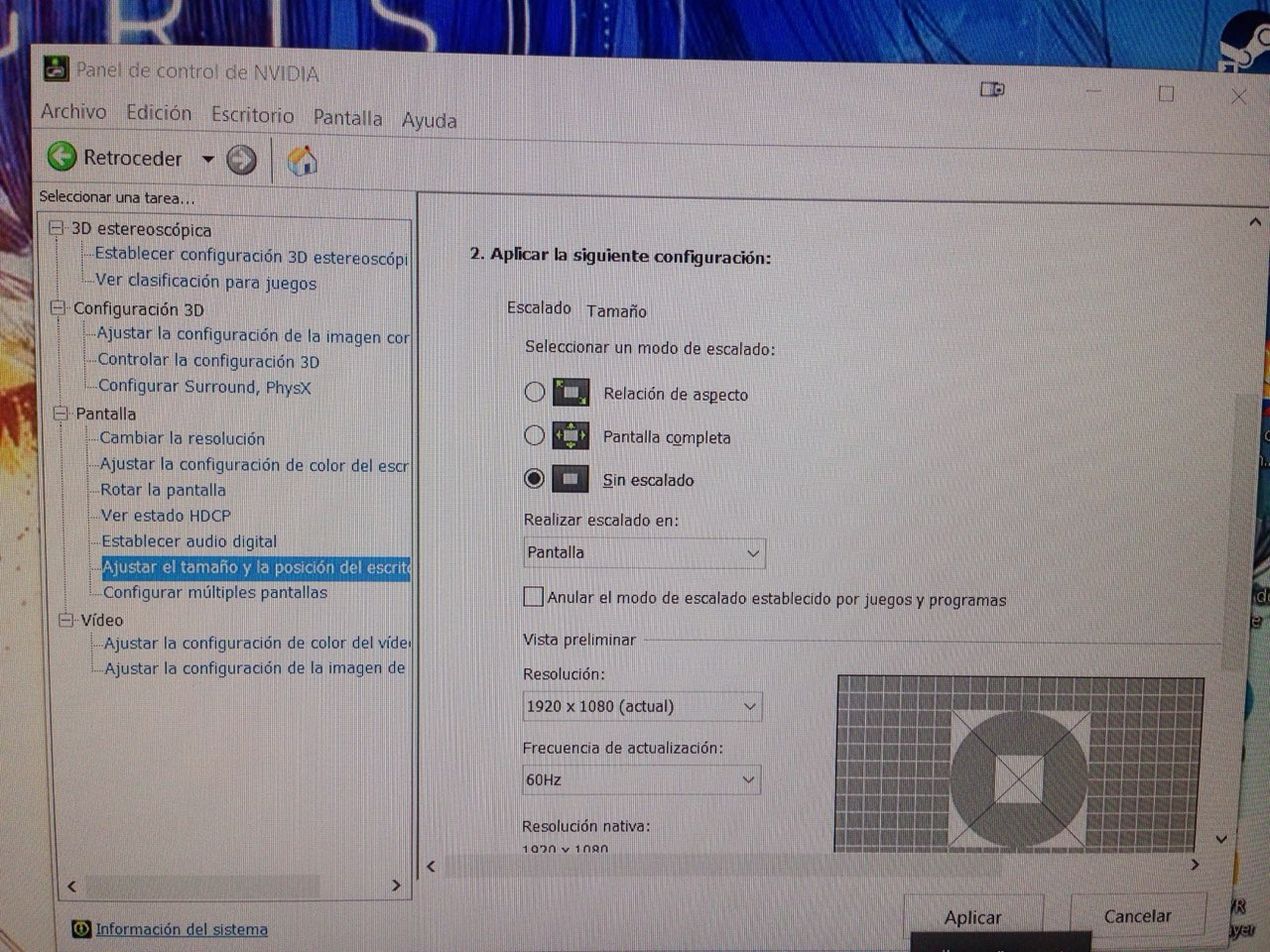

From my (spanish) friend:

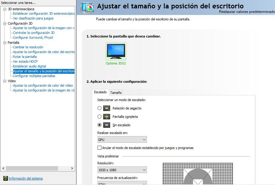

Another one:
My friends report that they also get about 2-3fps more, since their nVidia don’t have to rescalate.
I’m expecting more Spanish teammates with the Pimax 5K+ and 8K to do more testing, but one with the 8K says he’s tried his favorite games (and porn) and the improvement is substantial, almost equal to the 4K (he has one).
If I see that they all say the same thing, you better make a new thread on this topic or I will, as you want.
It is confirmed by two more friends with 8k who clearly see that it looks better , Although it doesn’t have any logic.
