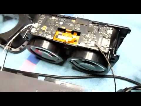

I have been contemplating a mod for some time to somehow improve the focus of my Pimax.
As I have posted before, I have had to use an extra set of lenses from low cost magnifying eye glasses to get a reasonable focus of the image in the HMD.
I am long sighted and have to wear glasses for reading books, PC screen etc and even with my glasses on, Pimax was not focused properly for me without the extra lenses.
It was a pain having to have those stuck onto the Pimax lenses and at last I decided to have a go at a mod I though up and at the same time, replace the lenses with a new pair that Pimax kindly sent me several months ago.
I’m hoping the video explains it in enough detail.
Now I’m not much of a video maker and I have left a lot of the disassemble and assembly procedure off because there are already a few videos that show that process in detail.
So checkout this YouTube video and I hope it helps you if it’s something you were thinking of have a go at.
Resultsstrong text
The mod was a total success and now I have a perfectly focused image and since I removed the blue filters at the same time, the image is very crisp and striking (and quite bright).
I did have to set it to the lowest brightness to help hide the motion blur and make it comfortable to look at. Actually it would be good if it were possible to reduce it a bit more. A slider control and more variation range would be great.
The mod has made a huge improvement to my VR experience.
I still wear my glasses, but I don’t need to extra lenses any more.
Cheers, Luke

Must say I was a bit unsure if this would work out and I’m relieved that is has.
In my opinion it proves that if Pimax modified the design of the lens holders so that the lenses could be moved either side of the default position by just a few millimetres, I think that it would allow focus adjustment that would suite the vision of most people.
