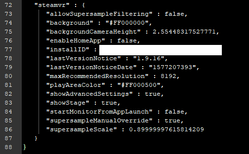

SteamVR reintroduced hardcap on 4096 horizontal pixels again, removed it, back in, etc. That’s less than the Reverb’s horizontal 4320.
In SteamVR’s both channels it is currently back in, and must be adjusted by hand. Turn off all VR apps, navigate to %/Steam/Config/ then open steamvr.vrsettings with Notepad++ scroll down, and inside “steamvr” : { you change or add the line “maxRecommendedResolution” : 8192, settings
Your Reverb’s clarity will probably increase back to normal. It is also mandatory for any Pimax user playing in Large FOV through SteamVR right now - which may be many, for example when using Index Controller profiles, or similarly if you don’t start through PiTool because of it still producing frametime spikes. :+1:

Careful with this , I think most of my crashing issues 8 months ago was due to messing with this file.
I use pimax 5k+ with large fov and no longer touch that file and games look fine. I wouldn’t go as far as saying its mandatory.

but if you go wide fov without having done this first you’ll get a pixelated image.
