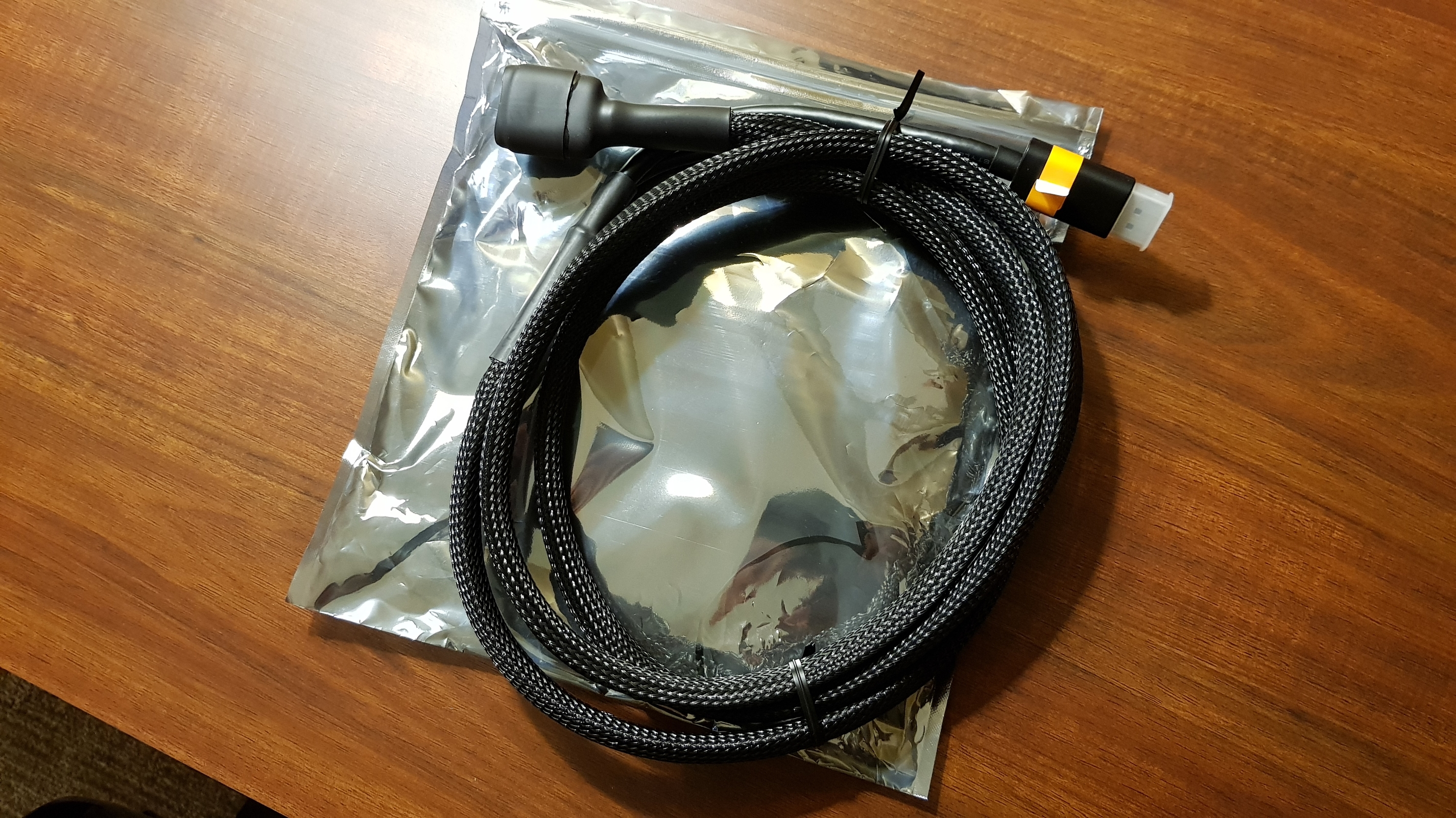

Finally we got the 2m extension cable which we ordered before CES. It arrived too late for CES but at least its here now. I will unpack the stuff (headsets etc) after the dinner and will try the cable both with laptop and desktop PC.
Stay tuned!

Progress so far:
I had only been able to test the extension cable with my laptop + MiniDP-DP adapter (the adapter works good with 8KX without extension).
Using the 2m extension:
  • In DSC (Native) mode: Not working
  • in Upscale mode: Works as normal
I am not sure if the MiniDP-DP adapter might be the problem here, but it doesnt look good anyway. Getting an error 10936 in PiTool saying DisplayPort is not connected.
I somehow believe the cable does not support DSC mode. This cable is only confirmed to work with HP Reverb and I dont know if HP Reverb uses any DSC mode at all?
I will check tomorrow using the desktop PC with RTX2080Ti.
I will also order another 2m extension cable from Amazon that supports hbr2 and hbr3 DSC.

Thank you for continuing to investigate this feature for us, it is very much appreciated.
At least that it works in upscale mode is already good news I think.
Could you revisit your old 5 extension cable and try it with the new 8kX cable and finalised unit ? I n upscaler mode :+1:
I didn’t bring the 5m cable, but will do once Im home. Or maybe we can find a 5m cable here the upcoming days.
Sure, i think extensions are important so I will keep digging until I find a way :slight_smile:
The new cable is ordered now, will arrive in 2 days and if it works we will demo it on the roadshow as well.
Will keep u posted!
