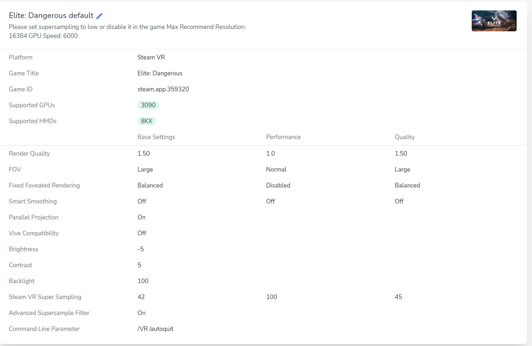

I pushed a profile with 3090 for this game and 8KX.
It has to work and be recognized.
Please restart everything, it has to work.

One thing that is bugging me. When I play Elite on my 4K monitor I set the in-game graphics settings to 3840 x 2160 fullscreen. But if I start Elite in VR (from PE, with the settings provided above by @Timo.H1) I find that the in-game settings report that the display has been set to 1280 x 768 windowed. Is this right? If not, what is causing it?
Thanks
the settings in the Windows window should be lower.
it saves performance.
the 3090 is at its performance limit anyway
