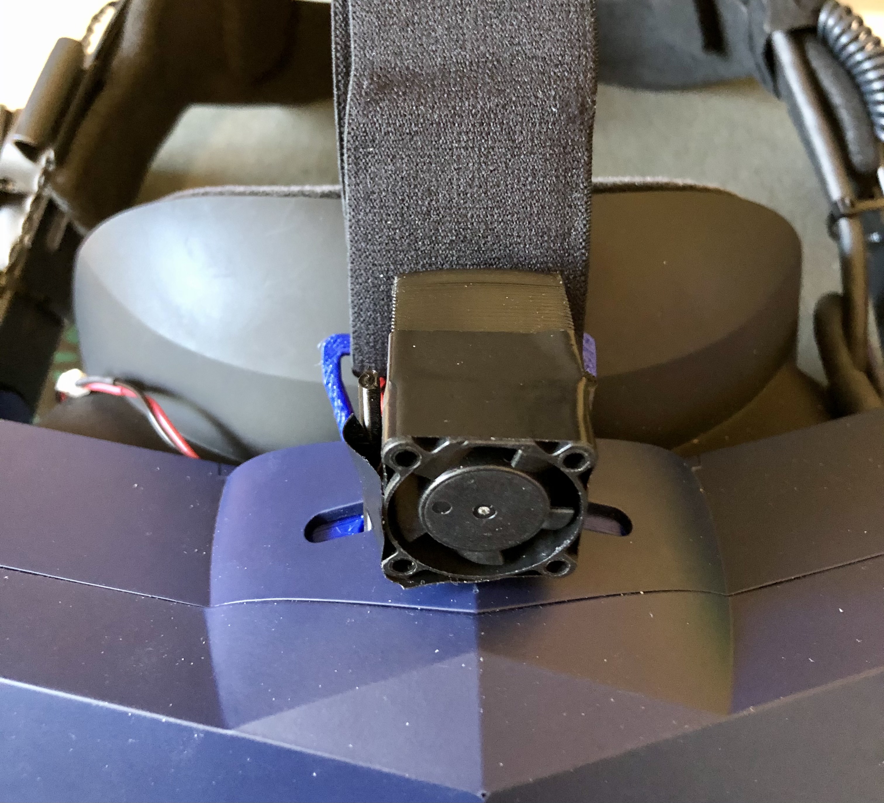

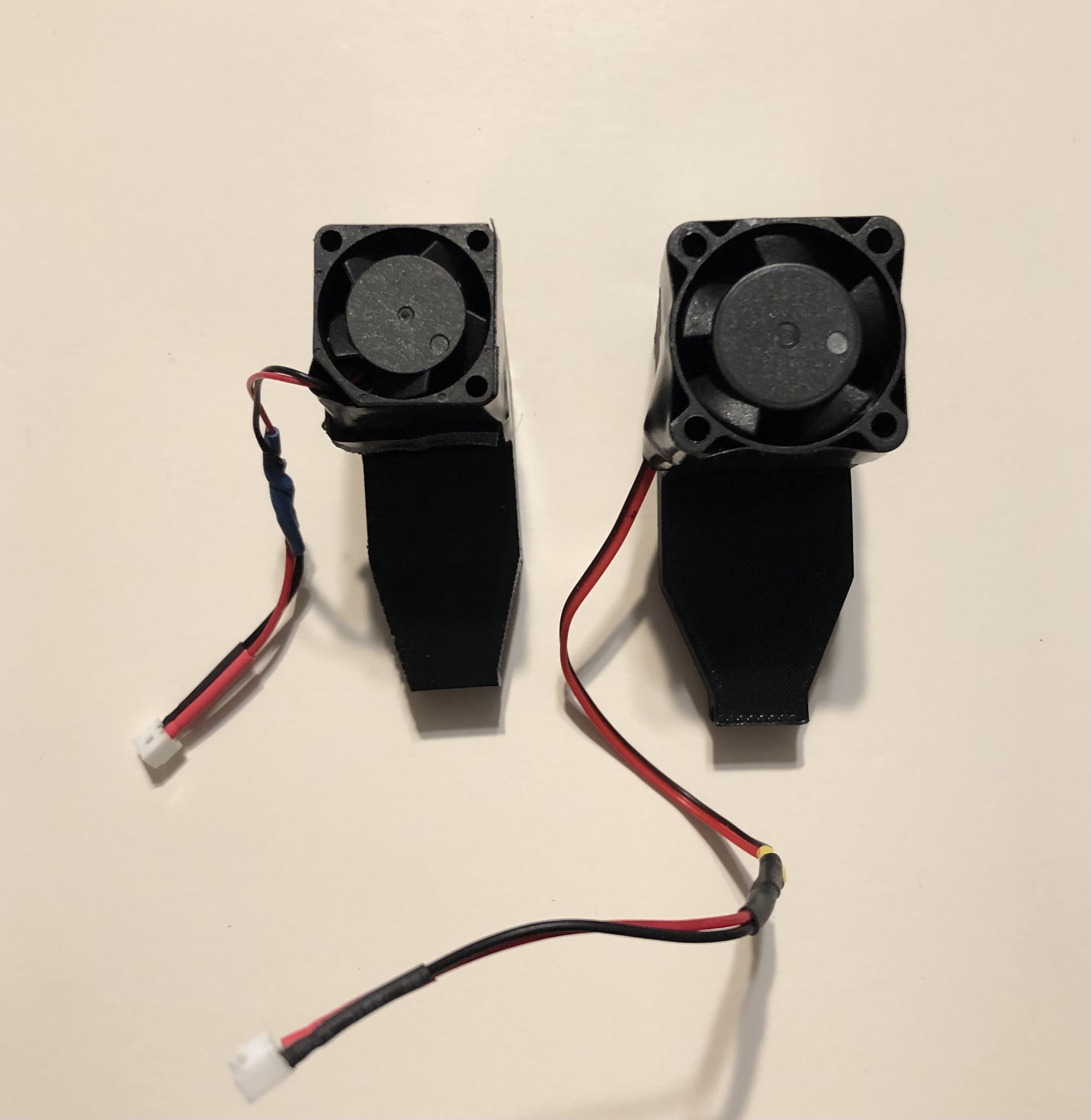

OK so I worked more on this project and tried two different other fans. I like the original 20mm snorkel fan but did find a 25mm version on Amazon that I made the 3d print file for.
It has the same 8mmx12mm end point but it does push a little bit more air and it is quiet like the 20mm version.

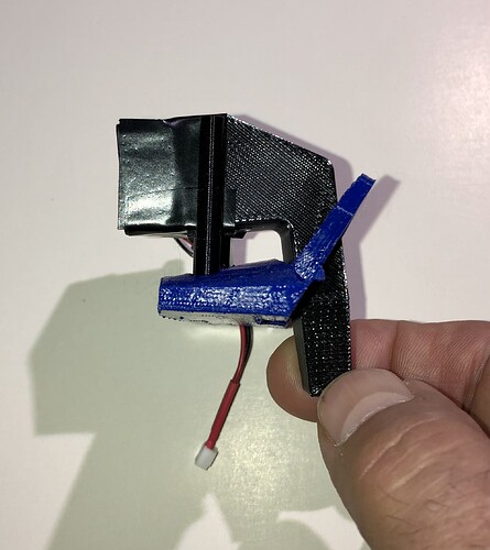

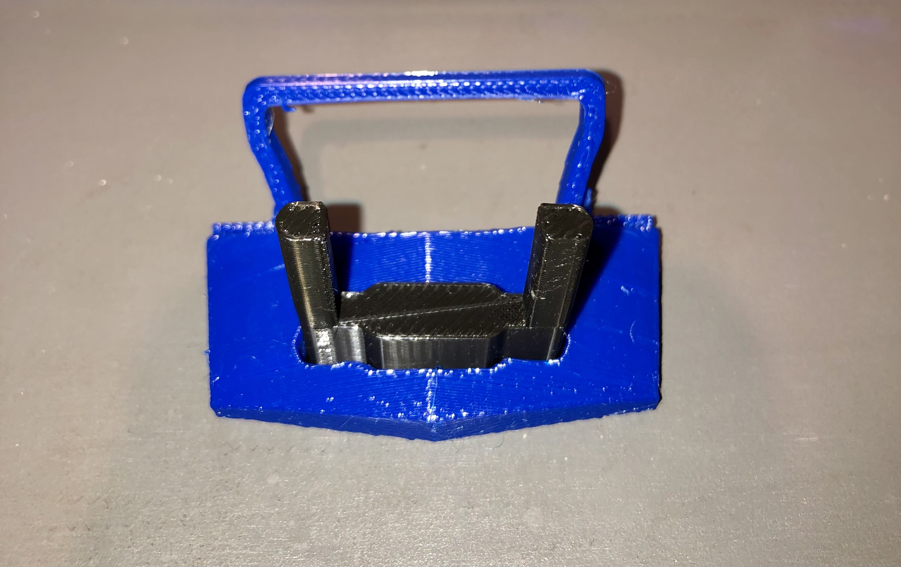

I also remade the DAS peg insert to stabilize the Fan snorkel for both the 20mm and the 25mm version.
I ran the 20mm version on a single cell 3.7v lipo (550mAh) for 20 hours before recharge.
I also found a USB C breakout for providing 5 volts from the headset. The extra voltage does provide more RPM. Just do not exceed 5 volts.
25mm 5 volt fans (two pack)
USB C breakout
I have uploaded the new files to: Pimax Fan Snorkel (8KX and 5K with comfort mod) by SideKick - Thingiverse

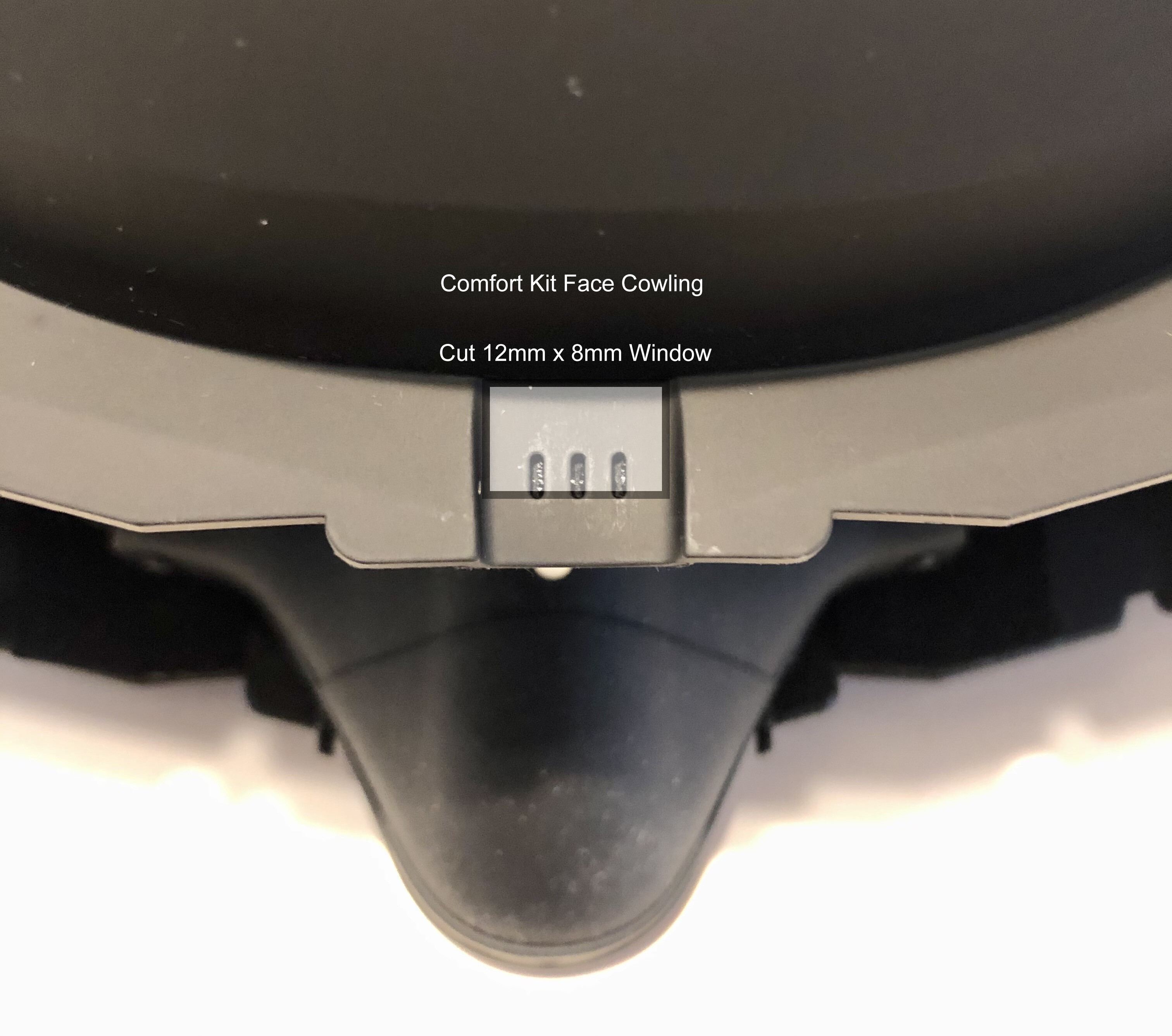

A picture of where you cut the 12mmx8mm window in the Comfort Kit Face Cowling
Thanks for continuing to share your progress.
The snorkel fits snug as a bug into the cutout and once I have the DAS adapter, I‘ll give the entire setup a go and let you know how I get on.

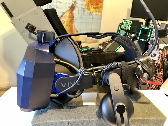

Great!! It sure made a difference to me on those two hour missions - that 8KX is warmer than my old 5k Plus for sure.
I little thin double face foam tape worked well on the bottom of the snorkel to the DAS peg.

Because that is how they work with my Fatshark FPV goggles . I feel the nice cool air flowing in - you can flip the fan around if you like. I have tried it that way and it doesn’t feel as nice to me.

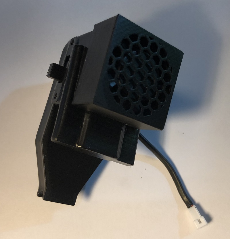

thanks for the great idea, I also implemented it.
Extended with a switch (off/50%/100%), 5V from the top USB-C port.
Just tested and it works well, have no fogging of the glasses …
Greetings
Uwe
Excellent work! did you update the files on the Thingiverse as a remix? People would appeciate it!

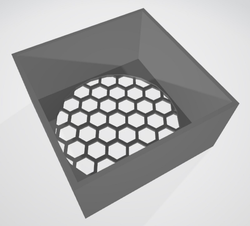

I just created the cover for the fan.
SnorkelFan_25mm and Pimax_DAS_25mmSF_Peg is your original, the parts are glued together.
You can upload the cover (for fan 25x25x10) at Thingiverse, I don’t have an account there.
I can send you the stl file by e-mail, you can send me your e-mail address by PM …

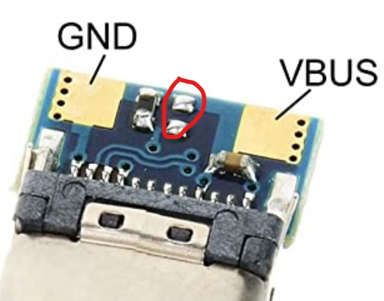

Attention, with the USB-C plug you have to be careful that the pullup resistor is properly installed.
I ordered two and with both he was from A5 to VBUS, Correct would be A5 to GND.
On the picture of the order he was set correctly, but delivery was the wrong one.
Here he was soldered, this is wrong:
usb-c_fail
It should be like this:
usb-c_ok
If you are experimenting with the USB-C port be careful, very quickly you can damage the HMD!
Greetings
Uwe
That’s why I used the Lipo – I was worried about that!
I did not use the plug, I slaughtered an adapter cable from USB-C to USB (skin removed from the plug).
