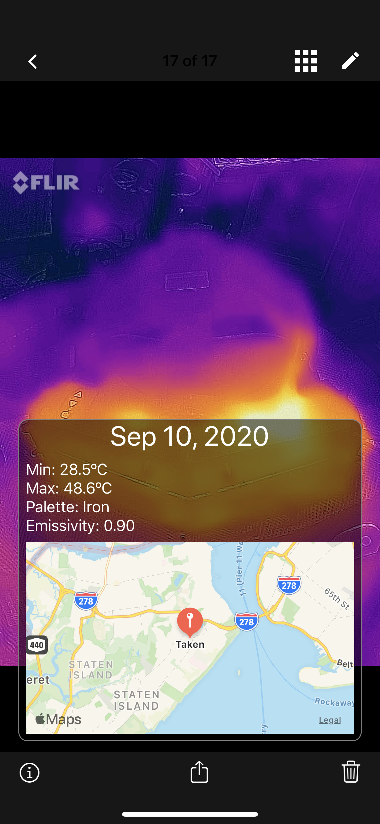

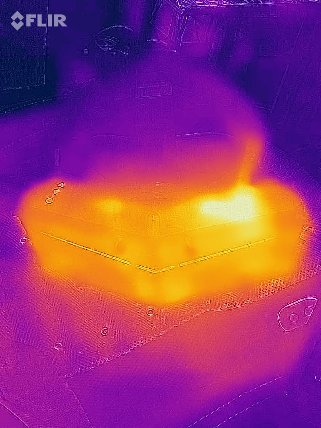

I got the flir camera today as well but surprisingly today the headset feels ALOT more tolerable and it doesnt hurt to touch the connector any more. Although it is showing over 40C on the first pics ive taken.
See below. It is getting hotter though. Ill monitor it because maybe it just hasnt gotten to the high temps ive felt before which was alot more than it feels like with the pics i took below
A few minutes later. Its got a little hotter. Still doesnt feel like it did before.
Another few minutes later 48.6C showing
Ill try again after a gaming session because even now it doesnt feel as hot as it was before. Hopefully it really doesnt get worse than this because at this temp it feels tolerable and i can touch it without it feeling too hot
