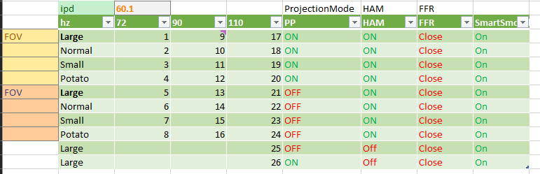

Should I sent you my results? @risa2000
I ran the tool and the extra one to generate the file but got distracted before going on. Or upload on github, what ever suits best.
This is a generous offer, I guess you would not make if you knew what it takes :wink:.
Technically, I would like to collect the data for all possible configurations, which are many with Pimax headset, basically any combination of the following conditions:
  • FOVs (Small, Normal, Large)
  • Parallel projection on and off
  • different refresh rates
Because we know, each of those factors may change the rendered FOV.
So you are looking at possibly 18 configurations to record. Now, if you know that, for example, the refresh rate does not change the reported FOV, you can skip that, but in order to know that, you might need to run the tool first…
Running the tool is not difficult (see this for the recommended procedure Contributing | HMD Geometry Database), but it takes time because each change requires restarting SteamVR, sometimes even the headset.
Considering all this, I would be happy for any subset you could provide.
:stuck_out_tongue_winking_eye:
OK I will try my best, 18 is manageable.:see_no_evil:

I ran through the following:
@MReis thanks for all the files, I am good now :smiley:.
I will run the “postprocessing” tomorrow (today) and add it to the database. It may take some time as so far I did not have to handle different refresh rates explicitly.
Thanks to @MReis I was able add Pimax 8k+ to the HMDGDB, and thanks to his thoroughness there are all possible configurations :slight_smile:.
