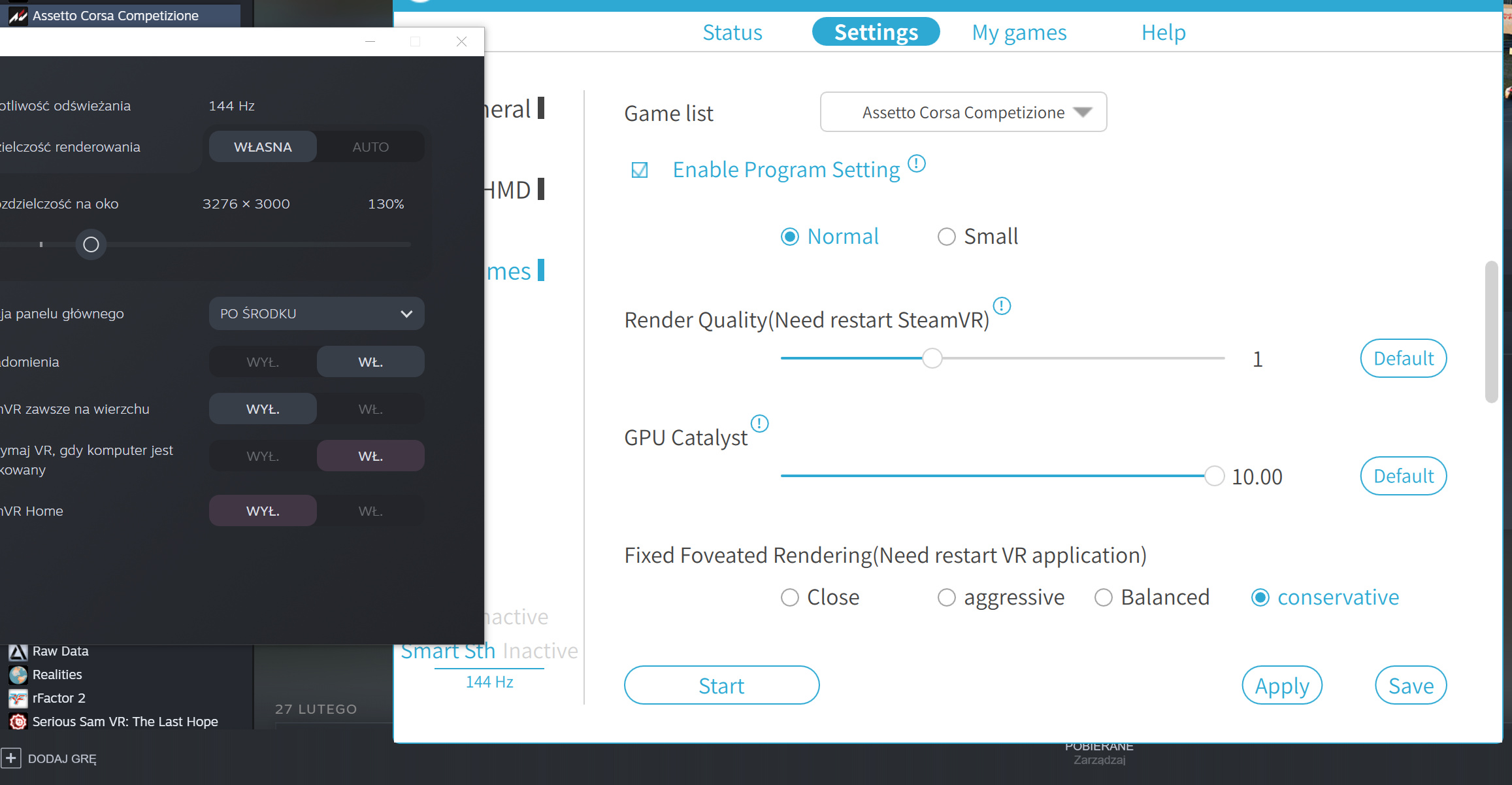

I have tested Assetto Corsa Competzione in my 5k+ 204 in 144hz with SM and normal FOV+FFR on. Absolutely fantastic ! IVery smooth experience without ghosting or frame lost in game. Only in main menu some stuttering during head movement like in 120 hz. Anyway love it. Solid “fake” 144fps , 14~15ms during race with 16 players…
My spec i7 8700k @4.7 + Strix rtx 2080ti OC

After playing around with 144Hz “normal FOV” mode, i must say im very impressed! First i had to adjust Pitool “IPD Offset” from -1 to -7. Because of double vision offset, changing from 90Hz to 144Hz. @Alex.liu
The FOV is surprisingly good, i thought it will be tiny, but no it´s very good!
I felt in fast paced games like Project Cars 2 and Assetto Corsa, my eyes and brain was much less claimed. It felt way easier to follow the track.
My eyes and brain was much more relaxed, which resulted in driving round after round easily compared to 90Hz mode.
I think this mode will also help people with motion sickness very much.
The only downside of 144Hz mode is the smaler FOV compared to 90Hz “large FOV” but it´s still very good and i think a good trade overall.
Thank you and nice job!
CPU: i7 7700K
GPU: 2080Ti OC
Pitool 258
Firmware 263
Nvidia 442.19
Win 10 64bit
SteamVR 1.10.28
