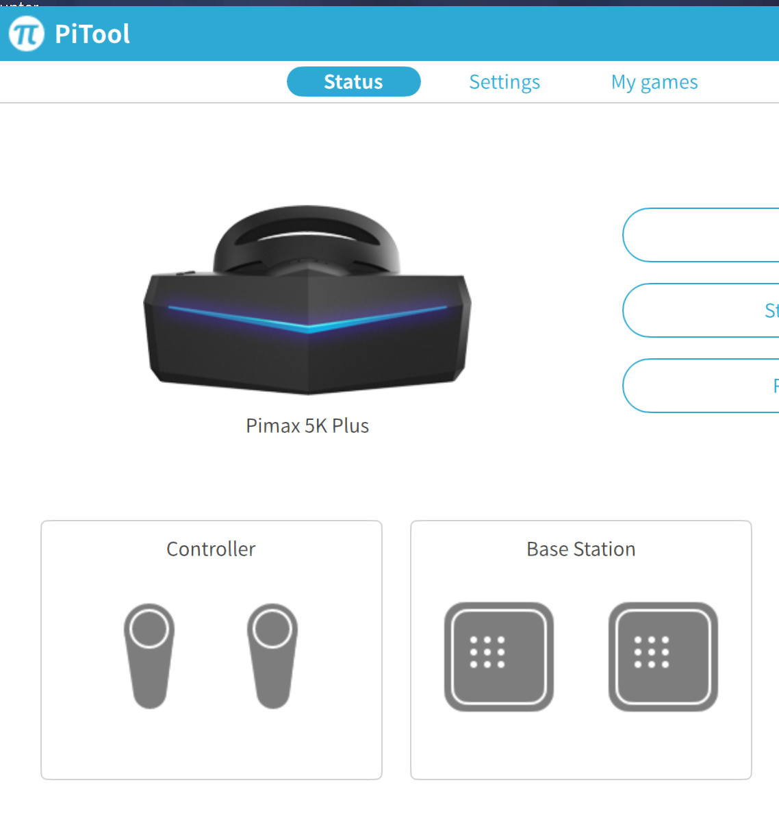

Well, it didn’t last long. This evening I’ve completely lost the controllers in Steam VR, but even PiTool doesn’t see them in green so I don’t think Steam VR is guilty here. I reinstalled Nolo Home just to check that the Nolo hardware was OK, and it is, they are working fine in the visualizer. Then I uninstalled Nolo Home again, but still no joy.
This software environment is simply and totally unstable :rage: See also the post about rebooting the 5k+ that I will do in the next minutes…
