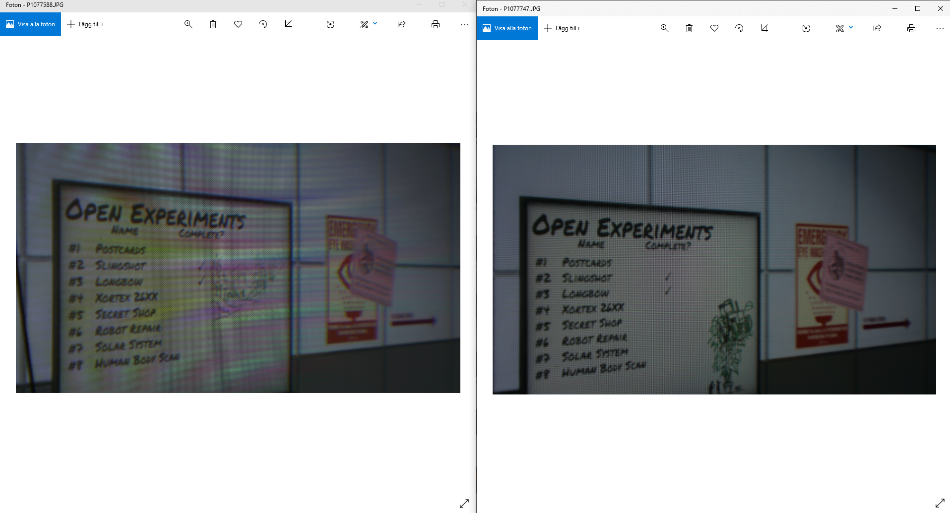

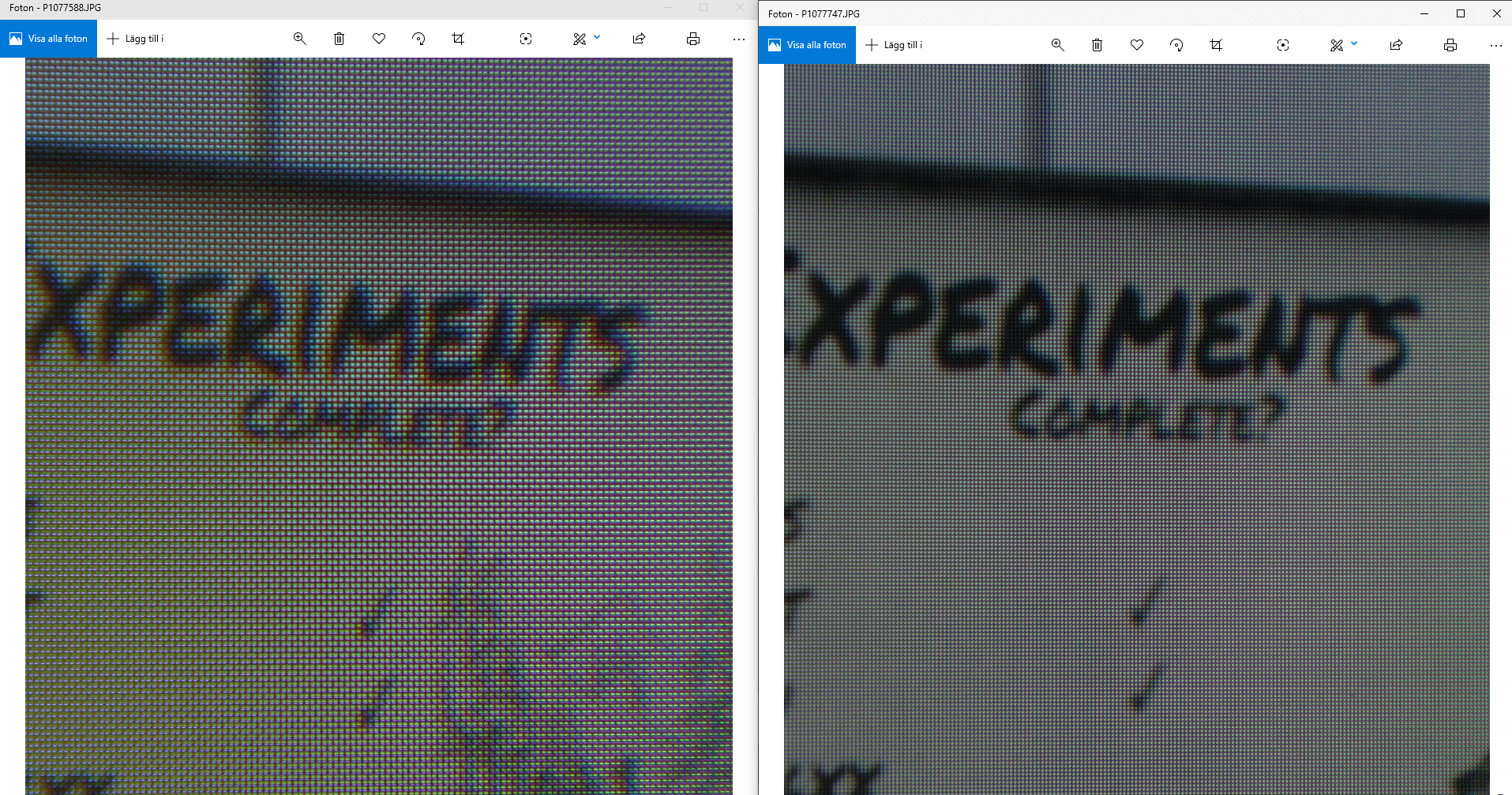

good points, for now i can check with small FOV, haven’t done that yet, just for science :slight_smile:
I can absolutely not agree there though.

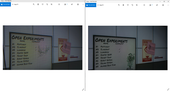

The 8K+ is way better than 5K+ in terms of details, readability, SDE and even distortion. My TTL images speak for themselves and people at VR Berlin and VR Space (who only tested 8K+) all said its way better.

If you dont see the difference here, then you cant blame the HMD itself
I never posted these images, taken long ago:
