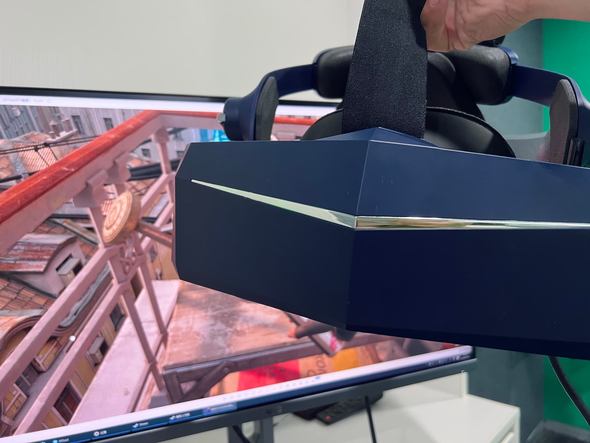

3090TI & 8KX Compatibility
We are happy to share the latest update with you regarding the compatibility issue with the 3090TI with 8KX. To address the compatibility issue, you might try using DP 1.4 Repeater.

So your saying Nvidia screwed up on DP signal strength?
:face_with_raised_eyebrow:The current test results show that it does need to boost the output signal, but there are likely other reasons, we have sent the situation and test results to NVIDIA .
This solution should maybe be explored by folks on the older 8kX. If the team has been able to reproduce the 90hz issues some experience on Nvidia setups.
Considering all other RTX 30series cards work it suggest Nvidia messed something up. The 3090ti required a specific new driver on release that was only for the 3090ti and you couldn’t use earlier driver.
Supposedly the 3090 Ti isn’t actually a 30 series card. But rather it uses hardware from the upcoming 40 series, a forerunner to the new line.
So that does make this issue more generally concerning because it could mean that all 40 series cards would have this same issue as it stands right now. I imagine that makes getting it resolved a high priority for Pimax.
But there may be little Pimax can do about it other than bringing it up with nVidia. Pimax posting about using this repeater to work around the issue is presumably just a stopgap measure until nVidia can fix it.
