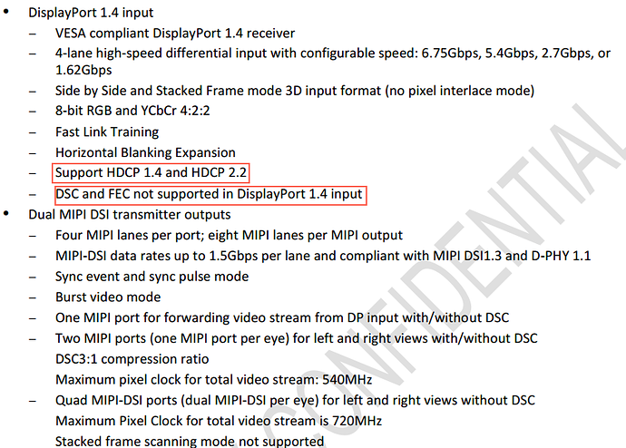

Good news guys, I found the actual input res. Pimax 8K V1 and V2 use DSC 2:1 with 16b/pixel color 4:2:0 on input. And were stable 90Hz.
If we use same mode on V3, we run into 720MHz limit that ANX7530 has.
Since Driver IC DSC mode is 3:1(2 mipi/panel/IC), we need to send to each panel 3840x1080@90 data, this means actual input res per HMD is 3840x2160. Actual 4K, as Pimax was saying in FAQ on KS, they removed that I think.

So it is pixel clock after all. But because of no DSC support on input… GPU has to do DSC compression(or at least color compression) for HMD to operate at 90Hz. That is my understanding. Could be wrong, probably not. BTW DSC on MIPI is by using anx7530 DSC engine 3:1, 2160hx3840v fed into it(not by using DSC but simple sub/up sampling) Huge loss of image quality comparing to DSC method to reduce BW on DP/HDMI(GPU-HMD cable).
Here are some specs, not to think I imagine stuff :slight_smile:
ANX7530 is DP interface/splitter with two display support. It is not a scaler. So it receives 2x 25601440 and outputs the same resolution. You may either consider it as two separate 25601440 frames or one frame 5120*1440 which is split. Either way you need to redo your math.

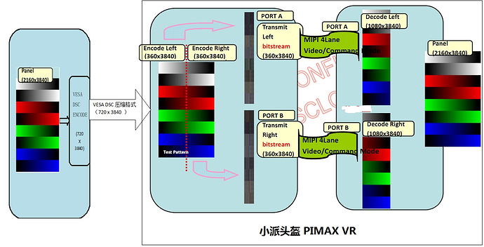

Idea was for sure to give 4K DSC signal(1080x3840) to Driver IC(where is integrated DSC decoder/scaler), how it works with ANX7530 I am not sure, it is maybe just signal inversion 2160x3840, so it uses SBS to send to one eye 1080x3840, not 3840x1080. My math is correct, check pixel clocks, same res just horizontal and vertical res are inverted in signal.
Yep, I don’t need to redo anything:
This is for DSC 3:1.
Also read again this:
Makes sense now that they did put 3840216080 number, does it? It confused me before, I thought they connect only one panel to test it at native res, but it is for DSC 99% sure.

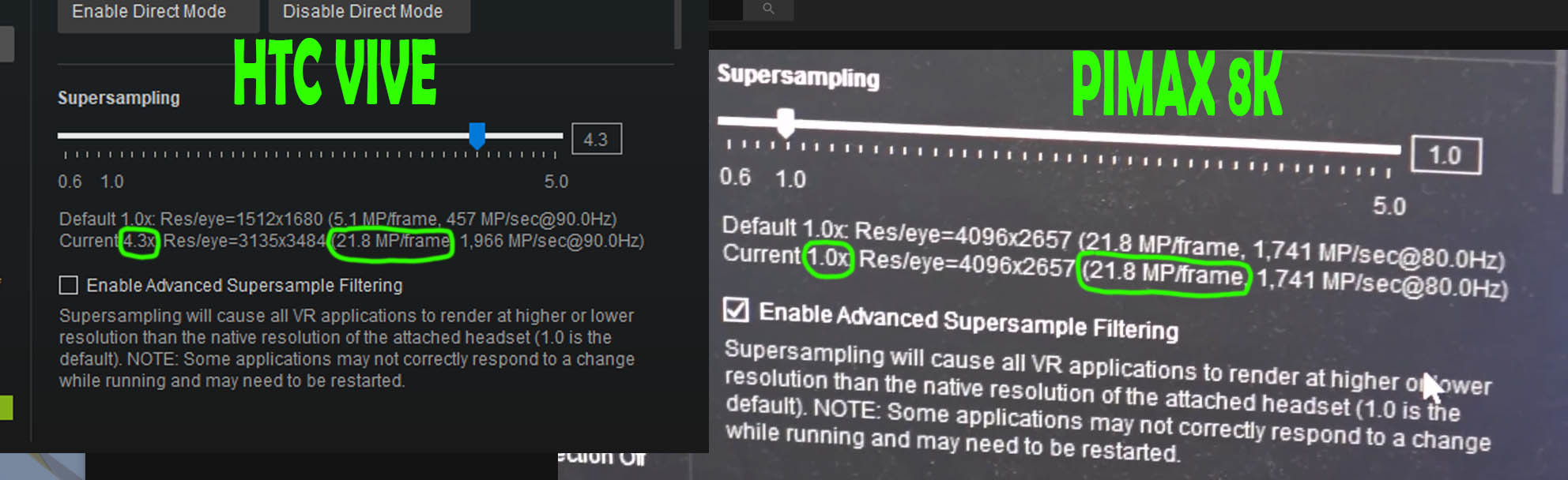

Here is math for real number for input res/eye,like what is 2160x1200(1080x1200 per eye) in Vive/Rift.
Output res/HMD is 3840x2160@80 (sent through cable)
Render res is: 4096x2657 / eye 8192x2657 total (SteamVR screenshot)
2560h x 1080v per eye/ target res after lens correction output
1080v x 2560h upscale to 1080v x 3840h per eye/ res to send to anx7530.
Real numbers: 2 x 2560 x 1080 , upscaled to 3840 x 1080/eye is signal sent, just inverted 2x1080v x 3840h is actual input that is sent to HMD.

Edit: I knew something is wrong with 2657 number. Its not even number, in tech we usually have multiple of 2 numbers(binary world). This is just random number to confuse backers what is actual vertical res target after lens correction is performed. This can be 1080*1.4 for optimal performance, so 1512. More than that is SS(Steam VR slider), diminishing returns kick in, ok lets assume 1512 is 1x SS, 1.5 SS is beneficial 2268 could be actual number in use, who then just put 2657, notice 657, lol almost 567… This was sloppy job, it’s 2017 guys… You want to hide things from internet? :smile:

Your math is not correct at all. You assumed that the output resolution of the interface chip was 38402160, which is wrong regardless the interface, as Pimax clearly stated that the input resolution for Pimax 8K/5K was 2x 25601440, so the output will most likely be the same.
Then you proceeded to calculate pixel clock for this wrong resolution and then concluded that it does not fit into operating range of ANX chip. Even on V1 or V2 you are calculating with the wrong resolution.
It does not uses “signal inversion” nor anything else you are trying to make up. Read the spec. It is just an interface chip, which takes video stream on Display port on one side and outputs it over MIPI on the other side. No scaling, inversions what so ever.

The pre-warp render buffer is calculated based on supersampling factor and optical system characteristics. There is nothing wrong about ending up with odd number resolution.
SS factor factors the number of rendered pixels, not horizontal or vertical resolution. Rendering 1000x1000 with SS=1.5 gives you 1225x1225 render buffer resolution.

Same was with 4K, panel receive only DSC signal on MIPI, HW limitation, if you feed in native res(no DSC) you get 2160p@30 interleaved at 60Hz. No more discussion with you(in public).
Pimax 4K actual input res:
Driver IC in DSC 2:1 , 1080v x 3840h MIPI to Panel res (1 MIPI port used)
2560x1080 inverted and upscaled to 1080 x 3840
DSC 3:1 - 720v x 3840h MIPI to Panel res(2 MIPI ports used)
1440v x 3840h per panel(2 x 720 x 3840)
2560x1440 inverted and upscaled to 1440v x 3840h
Same principle is on 8K. Don’t wanna accept, you can’t - if you are biased.
