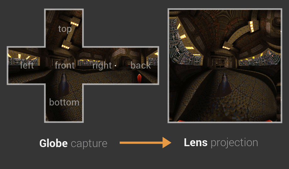

Difficult stuff to grasp. I kind of get what he’s saying. But look at that last picture, how would this then project onto 1 screen ? Or take the drawn picture that was posted before, how then would this look if you’d render it like a cylinder ?

Take a look at the video I linked. You see standard 90° projection, that looks fine. Then you see standard 120° which still looks fine. Standard 150° already looks a bit stretched, and standard 170° looks horrible. A bit later you see “Panini 200” where you see how a “correct” 200° FOV would look like, thats done with rendering multiple views. You can read more about it here: GitHub - shaunlebron/blinky: Exploring peripheral vision in games (using Quake)
Heres a comparison:
On the left you see what the Pimax headset is currently using.
The issue with the “correct” view is that you have to render a lot of different views per eye and thats more expensive to do:
Thanks ! I’m going to think some more about this. I have a feeling this indeed is the core of the problem.
@John_Alcatraz If you’re right (and I have a feeling you are), then we’re basically f*cked, right ? None of the games can render like this. It would need huge overhaul in game render engines. I highly doubt any game developer is interested in doing that, just because of a few thousand pimax 8k users out there.
EDIT although … in the ‘globe’ example, you’d just need 6 viewports and have the Pimax render those into the lens projection… I wonder if you can do that with SMP.
The games can render like this, its just more expensive. The important thing is that, and I’m not fully sure about that, the Pimax devs would have to design the lenses in a way that a correct image can be used. That would mean that the games would have to specifically support the correct rendering, so you couldn’t just play any existing SteamVR game with it.
The Pimax devs probably decided to do it the “wrong” way because they wanted to have all current games be compatible and they considered that more important than having a correctly looking game.
It’s not really an issue for game developers to support it since its just the engine that has to support it. Almost all games you see are either done with Unreal Engine or Unity, so someone could just release a “Pimax Plugin” for the engine (or the engine could just directly add support for it) and then all games made with that engine could just use it. The developer of the game has to add that though, so at the beginning most games would be incompatible.
