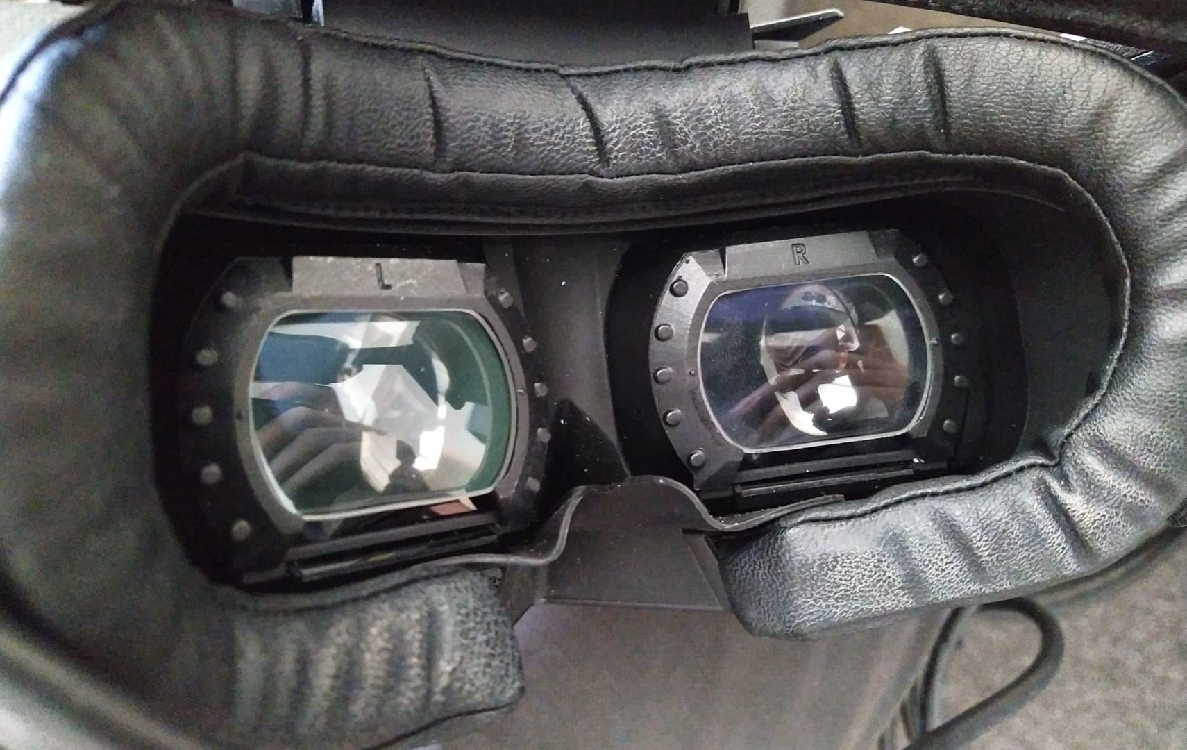

Actually they just sent me some photos of their lens inserts:
They said that costs of the lenses, the modification of the headset and the shipping back of the headset comes at about 500 euro. I’m planning to have this done.
It does seem though, going by those photos, that the lens inserts would diminish the FoV … Going to find that out before placing the order

I think this prescription will limit the FOV vertical and horizontall. I heard from many people that those lenses will nearly always reduce the visible FOV. In the pictures this lenses are looking smaller than the lenses of the headset. Also some area of the headset lenses are blocked by the prescription mount.
I hope that I am wrong, but this is what I know from other people around me.
