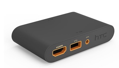

It’s not possible as the Vive breakout box takes HDMI in, it’s crucial that PiMax has a breakout box, room scale VR is much harder without it, also the need to turn off the base stations wirelessly have to exist.
@aesopfabled @Kopa, sorry, I can’t find any HTC breakout box informations, could you share us the product picture. For HTC VIVE lighthouse What I saw is the user has to unplug the power.
@bacon Wirelessly turning off the base stations is a SteamVR feature and has been from the very start, very concerning if you don’t have this, we absolutely do not want to have to pull the plug on our base stations.

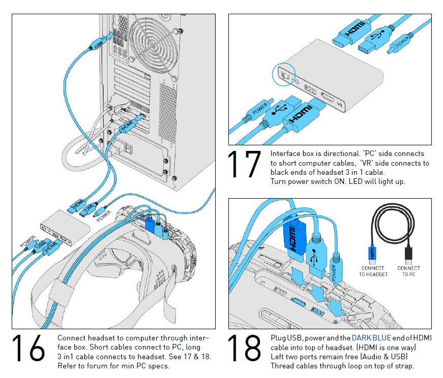

This is a drawing of the breakout box

yes, this box I know and we have a sample, it is a power supply for HMD, can’t control the basestation. but it seems not your displayed version.
It also has a Bluetooth receiver in it to communicate with light houses to shut them off and turn them on.
You can also google: HTC Vive breakout box
Done well it could enhance the signal, perform antialiasing, and shut off or activate the lighthouses. Done poorly it will add horrible delay. It should also be noted that the breakout box is inexpensive, and protects the cord from ripping out of your graphics card and potentially damaging it.
