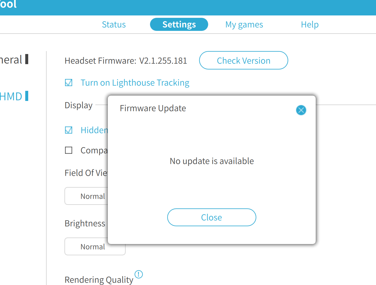

The firmware, at least Pitool says, is the latest.
