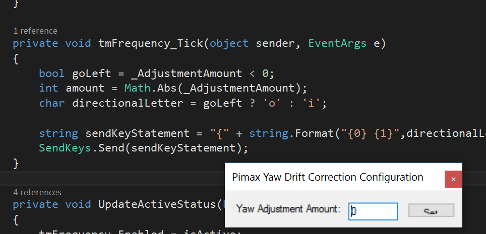

So, I just about have a working prototype. Its an application that exists in your tray, clicking it will open a config menu and stop the yaw adjustments… after you click set it will disappear to your tray and become active.
In my initial attempt I made it just for LiveViewRift, as they use the two leffters i and o for yaw adjustment.
I set it up so once it becomes active a timer will periodically send 1 or many i’s or o key presses which should make LiveViewRift adjust.
… this is my current snag. Looks like I will have to do a lower level method of sending a key, or send a joystick message because currently liveviewrift doesnt pick it up. If I enter notepad, I see my application is making either i’s or o’s, and in LiveViewRift if it actually type i or o it move the camera… but currently I’m still working on my app talking to LiveViewRift.

Hi Feranti,
yes… but the current ‘proof of concept’ version only support liveviewrift. The latest version… actually any version but you just need to edit the app.config file with the windows title.

This is just proof-of-concept- and currently is making to great of a yaw correction… so magnitude of the values done seem to change the speed. But negative values adjust left, and positive values adjust right.

Open the yaw-corrector.
Enter the yaw adjustment amount. Currently just try -1, 0, or 1. and in LiveViewRift you should see it start moving left or right.

it seems I cant control the magnitude of the change the way I am attempting to; instead I will try adjusting the timer interval.
Let me know if the adjustment gets your liveviewrift to pan either left or right.
The next release I will make finer adjustments… maybe so that 100 moves as fast as 1 does now.

As I mentioned this version is just a proof-of-concept, it works in my testing of LiveViewRift but corrects the drift too much.
Hopefully I can fix that today. I will will add three-hot-keys which are always listening, that way while in LiveViewRift, you can hit one key to zero the yaw corrections, and two two keys to either increase the correction value or decrease it.
I am thinking that would be the most practice.
This way all you would have to do is, run LiveViewRift, start the Pimax Drift Corrector… then while watching your movie if you notice a drift just hit the appropriate hot key… to increase or decrease the correction in that specific direction.
